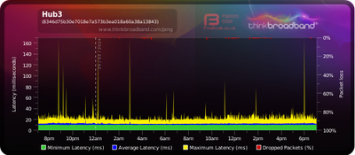

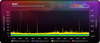

Hi had some work on my local network done today as it says it was doing upgrade work to improve the services,
But after being down for half the day when the hub came back online I saw the power levels are way out if sync now. The downstream before was between 0 and 3dbmv and the upstream dbmv was about 38 dmbv, now the downstream is +10 dbmv and the upstream is now around 34dbmv, do I need an engineer to fix it? I have a 6db forward path attenuater fitted at back of hub which i could change to a 10db forward path attenuator to bring down the downstream power levels but its the upstream I'm concerned about as its only 34dbmv?
Have I a problem now?
