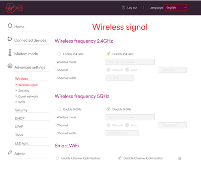

    Well, after a bit of exploring the Hub 5 Router settings,
    I never realised that I could disable both the 2.4 and 5ghz wifi as well as the wifi optimisation so even in router mode, there is now no wifi being broadcast.
    After a few days use, everything seems to doing what is expected.
    So with the wifi actually disabled, are there any operational differences between how it is now and being in full modem mode?
