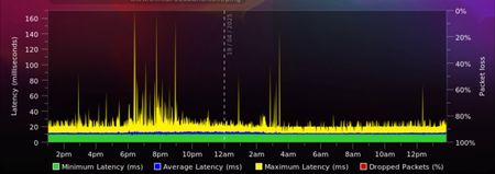

Just a question about this really. My minimum latency sits around 18 or 19ms on a ping graph but I’ve seen others connections a lot lower about 10ms or even a bit lower. Is this based on how far you are from the exchange / cable box on the street or local area connection? The think broadband monitor graph shows the main min area in green, just interested how it works and how some people show it much lower. My connection seems fine but this past week seen a lot of dropped packets on my graph but seems to show every other day or so. Can you check if there’s any issue on the line happening? I’ve done a check and it says my home network has a few problems with a Red triangle next to the broadband bit, all the others are normal in Green. PS: I use both Ethernet & Wi-Fi180Views0likes7CommentsFootball games unplayable on ps5

I've been having issues where my connection experiences spikes and complete dropouts, 30 minutes apart. I have been running BQM since Friday 6/6/25, as you can see in the attached graph from 8th-9th, the space between drop outs are quite consistent. I have: - Fully reset to factory settings. - Disabled IP Flood Detection (suggested solution on another site) - Tested other devices (another PC, 4 Phones, Xbox Series X, 2 TVs) all experience the same connection issues. - Pinged various IP Addresses and all came back with no loss. I am connected via Ethernet to the 10gbps port, my PCs ethernet port is compatible with those speeds: https://www.speedtest.net/my-result/d/812c9d78-d2e7-4766-9f17-9cd7acd688b1 Other devices are Wifi (PC is Wifi 6, rest are 5ghz/2.4ghz) Package Info: 2gig up and down These are my router stats: PON modem status Online Connection mode IPOE IPv4 firewall Online IPv6 firewall Online IP_VOIP Down IP_DATA Up Transceiver temperature 29 Transceiver voltage 3 Laser bias current 12 ONT transmit power 5200 ONT receive power -16400 Network access Allowed Baseline Privacy disabled PON Mode XGS-PON 09-06-2025 11:12:46 notice GUI Login Status - Login Success from LAN interface 09-06-2025 11:11:29 notice erouter0 ipv6 address is empty 09-06-2025 10:56:29 notice erouter0 ipv6 address is empty 09-06-2025 10:41:29 notice erouter0 ipv6 address is empty 09-06-2025 10:31:20 notice GUI Login Status - Login Success from LAN interface 09-06-2025 10:31:14 notice GUI Login Status - Login Success from LAN interface 09-06-2025 10:30:37 notice GUI Login Status - Login Success from LAN interface 09-06-2025 10:30:06 notice GUI Login Status - Login Fail from LAN interface 09-06-2025 10:26:29 notice erouter0 ipv6 address is empty 09-06-2025 10:11:29 notice erouter0 ipv6 address is empty 09-06-2025 09:56:29 notice erouter0 ipv6 address is empty 09-06-2025 09:41:29 notice erouter0 ipv6 address is empty 09-06-2025 09:36:50 notice IPoE IPv4 ping failed 09-06-2025 09:26:29 notice erouter0 ipv6 address is empty 09-06-2025 09:11:29 notice erouter0 ipv6 address is empty 09-06-2025 08:56:29 notice erouter0 ipv6 address is empty 09-06-2025 08:41:29 notice erouter0 ipv6 address is empty 09-06-2025 08:37:10 notice IPoE IPv4 ping failed 09-06-2025 08:37:00 notice IPoE IPv4 ping failed 09-06-2025 08:26:29 notice erouter0 ipv6 address is empty 09-06-2025 08:11:29 notice erouter0 ipv6 address is empty 09-06-2025 07:56:29 notice erouter0 ipv6 address is empty 09-06-2025 07:41:29 notice erouter0 ipv6 address is empty 09-06-2025 07:36:49 notice IPoE IPv4 ping failed 09-06-2025 07:36:39 notice IPoE IPv4 ping failed 09-06-2025 07:26:29 notice erouter0 ipv6 address is empty 09-06-2025 07:11:29 notice erouter0 ipv6 address is empty 09-06-2025 06:56:29 notice erouter0 ipv6 address is empty 09-06-2025 06:41:29 notice erouter0 ipv6 address is empty 09-06-2025 06:36:59 notice IPoE IPv4 ping failed The network logs go much further, with regular error messages stating "IPoE IPv4 ping failed". This will be the 2nd router I am on, having the 1st replaced by an engineer for similar issues. Frankly, at £96 per month, I expect a far superior service. The speeds are good, sure, fantastic even. But it's no good having "lightning speeds" when you can't use them! If anyone else is experiencing this issue, or similar, please feel free to contribute your findings. VM, I eagerly await your advice/solutions as this is now affecting my employment. Regards.565Views0likes6CommentsAnother Hub 5 user with latency issues...
