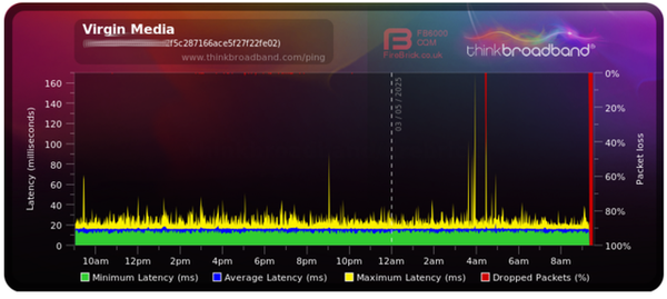

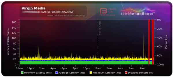

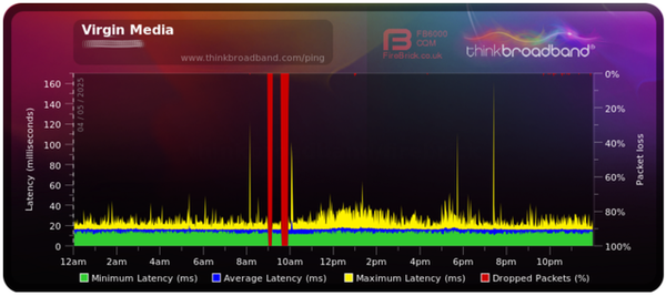

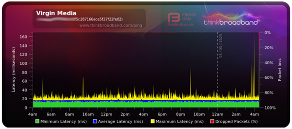

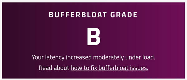

Another Hub 5 user with latency issues...

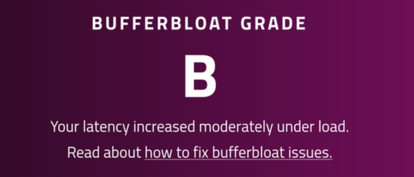

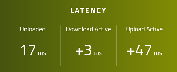

I know some people have had issues with the Hub 4 as well, but I have not long moved from a Hub 4 to a Hub 5, because I wanted the 2.5G port to benefit certain devices and max out the connection. I never experienced an issue with the Hub 4 and I had very consistent ping times of 6/7ms and latency on both download and upload <18ms at all times. However, since getting the Hub 5, I have have worse latency and awful latency spikes. Speed is on point, but latency sucks. Sites that measure buffer bloat have downgraded me from an A to B rating and low latency gaming is suffering.
My kit: Hub 5 in modem mode > 2.5G eth port > OPNsense box with ample capacity. I use Unifi access points (all testing done via cable anyway). Even if my kit were the issue, which it is not, I would have had the same issues with the Hub 4.
So much for Virgin's latest DOCSIS hub. If I had known it was going to be this bad, I wouldn't have bothered getting it.
Before anyone asks - nothing else on my network has changed, I literally swapped it out with the Hub 4 and now I have this.
Any ideas? Can I get a new hub to see if that does it?

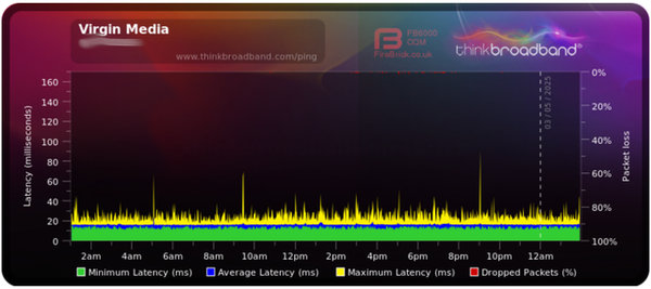

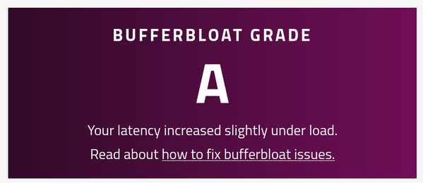

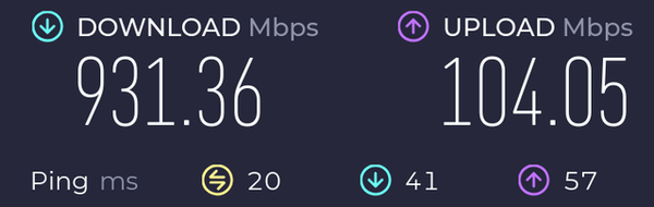

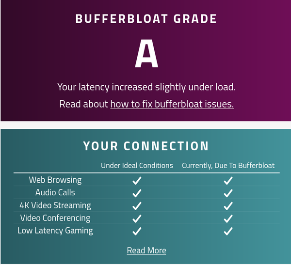

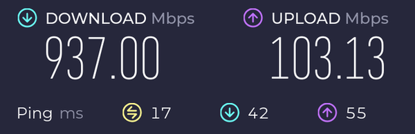

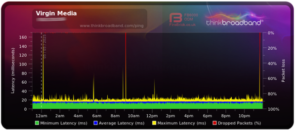

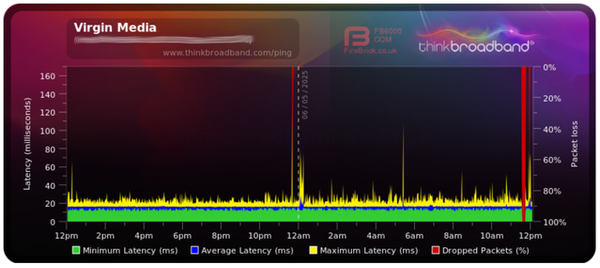

  • As it turns out, the issue was entirely on Virgin Media’s side. The fibre has been extended, the coax reduced to optimise performance with the Hub 5, and the previously incorrect attenuators have been replaced. Signal levels at the cabinet were also off and have now been properly corrected.
    So no - I wasn’t imagining it. And just to be clear: SQM isn’t enabled.
    For those who doubted - yes, this is what an A-grade result looks like when everything is set up correctly:
    Thanks to those who genuinely tried to help.
