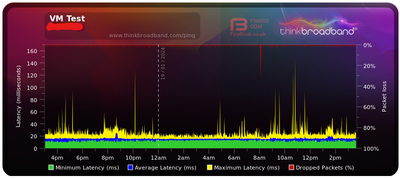

Latency Spikes
Ever since I renewed my contract and went from a Superhub 3 to Superhub 4, I have been getting latency spikes.  I have been monitoring this since 9th December and it happens every day.  If I am on a conference call or I'm streaming video, it causes the connection to stutter, sometimes streaming has to be restarted.  Do you know what could be causing this?
  • After playing around, I have identified the problem. I think the Deco S7 main box was causing the issue.  I did a  factory reset of the VM box and kept it in router mode. I then swapped the cables so that the main deco box was not between the switch and VM box and set it to Access Point mode. It's been over a week now and there have been no noticeable dropouts.
    Before:
    Deco satellites -> switch -> Deco main (Router Mode) -> VM Router (Modem Mode)
    Now:
    Deco Satellites + Deco Main (AP Mode) -> Switch -> VM box (Router Mode)
    Hopefully this will help others experiencing the same problem.

  • legacy1's avatar
    legacy1
    I would think you would see more timeouts going by your BQM unless its really low packet loss
    odd that your TTL is 61 and not 62 if you really did go to hub in modem mode

  • cookd53's avatar
    cookd53
    Before:
    Now:
