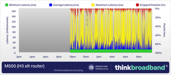

Engineer came around on Saturday and says everything is "fine" on my line, even replaced my Hub 3 router with a brand new one - after he left, I continued to monitor and test for a few hours, but sadly same issue persists! I've set up a BQM (I showed the engineer this, but didn't seem phased)

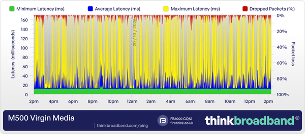

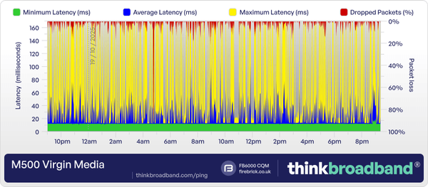

Here is my line with the BQM from ThinkBroadband (post the new Hub 3 as the graph looked the same pre-new Hub 3), you can clearly see the dropped packets - Clearly there is something very wrong with my line, please can anyone help!?

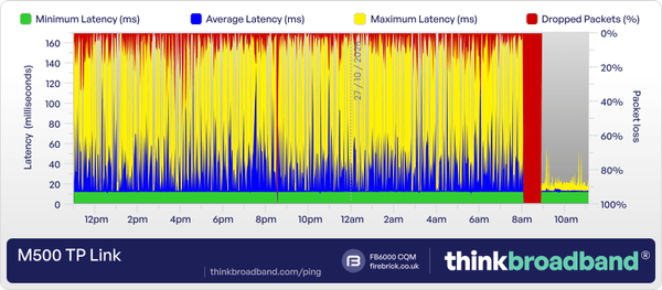

    Suddenly my packet loss/latency issues are resolved, here is the upgraded graph - you can see the night/day different after the 8am downtime:
    Latency and packet loss issues are now resolved. It seemed the solution was to replace the old coaxial wiring with fibre and fix a new coaxial converter for the Hub 3.
