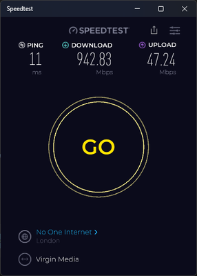

My upload speed test is lower than usual (90Mbps)

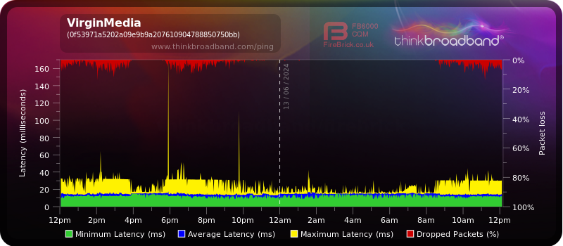

      I just created a new account on thinkbroadband, I'm already starting to see that there are packet losses.
      My Broadband Ping - VirginMedia
      • parmi's avatar
        parmi
        Anyone have any idea what's going on?
  • jpeg1's avatar
    jpeg1
    That illustrates your reported problem pretty well. How do those red periods coincide with your heavy use? Are there other times that are OK for you when you are streaming?

      Basically from the tests I have done, I can conclude that during the red periods I notice the following things:
      • Packet loss in game from 1 to 7 packet losses per second, also according to the graphics and statistics of the game the packet loss is only in upload, the download is ok, the game sends about 1KB/s of UDP data.
      • The upload speed test drops from 90Mbps to 45Mbps, the download does not suffer any drop.
      • My multistream to Twitch and YouTube suffers framedrops of around 40% (data reported by OBS), the streaming is set at a bitrate of 8000kbps, so I have an upload of around 16Mbps data, the in-game packet losses occur even if I stop the streams.
      There is no one else in the house using the connection during the red periods.

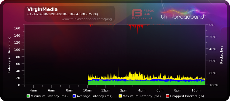

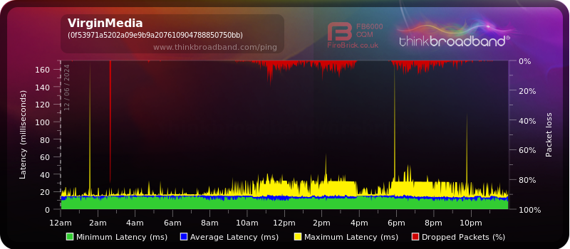

      From the graphs it seems that packet losses occur every day more or less at the same times, I have already received a couple of SMS from Virgin Media saying they have checked the connection and it looks good, and they will continue to monitor it until 13/06/2024 12:32:17.
      Reading other posts about packet losses, I have the feeling that this is the beginning of a nightmare.
      11/6/2024:
      12/06/2024:
      13/06/2024:
      Live graph:
