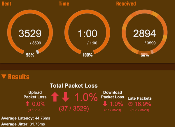

Hi, I seem to be having packet loss issues at the moment, very evident when playing online games, or running any test I will see the packet loss noted at around 3%.

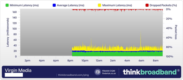

So it would seem that I am not getting any packet loss, however when you look at the thinkbroadband BQM you can see the packet loss.
What can I do about this?

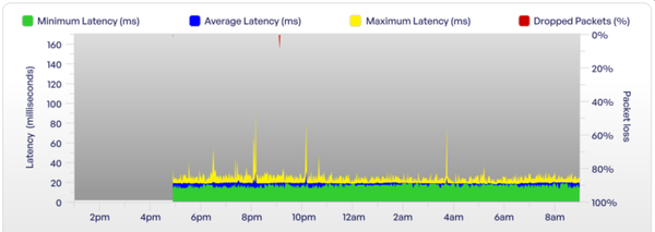

  • This issue is now fixed, I tried to put a picture of the line stats and explanation as to what happened but it keeps just disappearing, or more accurately not getting past moderation for some unknown reason. Either way after the engineer visit the issue is now resolved.
