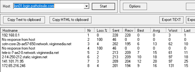

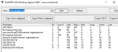

I have used multiple programs to try and observe the packet loss and try to figure out whats causing it, and most of the time it seems to be related to ip addresses that end with "network.virginmedia.net". This was with programs such as PingPlotter and WinMTR.

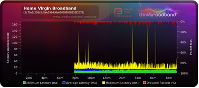

  • Thought I should also provide this, despite only starting it recently since I just found out about it, it also shows pretty clearly that there is an issue.

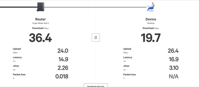

    Seeing only 36.4 Mb/s Downstream to the VM Hub should be the start of your focus.
    The bottom of the Realspeed test is cropped off,
    so we can not tell if 19.7Mb/s Hub Upstream is OK or is this low too ?
    Check the Downstream / Upstream status tabs of the VM Hub for signal level or error issues.

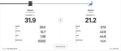

  • Here is the full screenshot of RealSpeed showing the bottom part.

    Finally, my broadband quality monitor which doesn't actually leak info like the one I blindly posted before.
