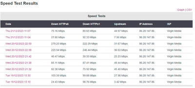

BQM results:
BQM1
BQM2
BQM3

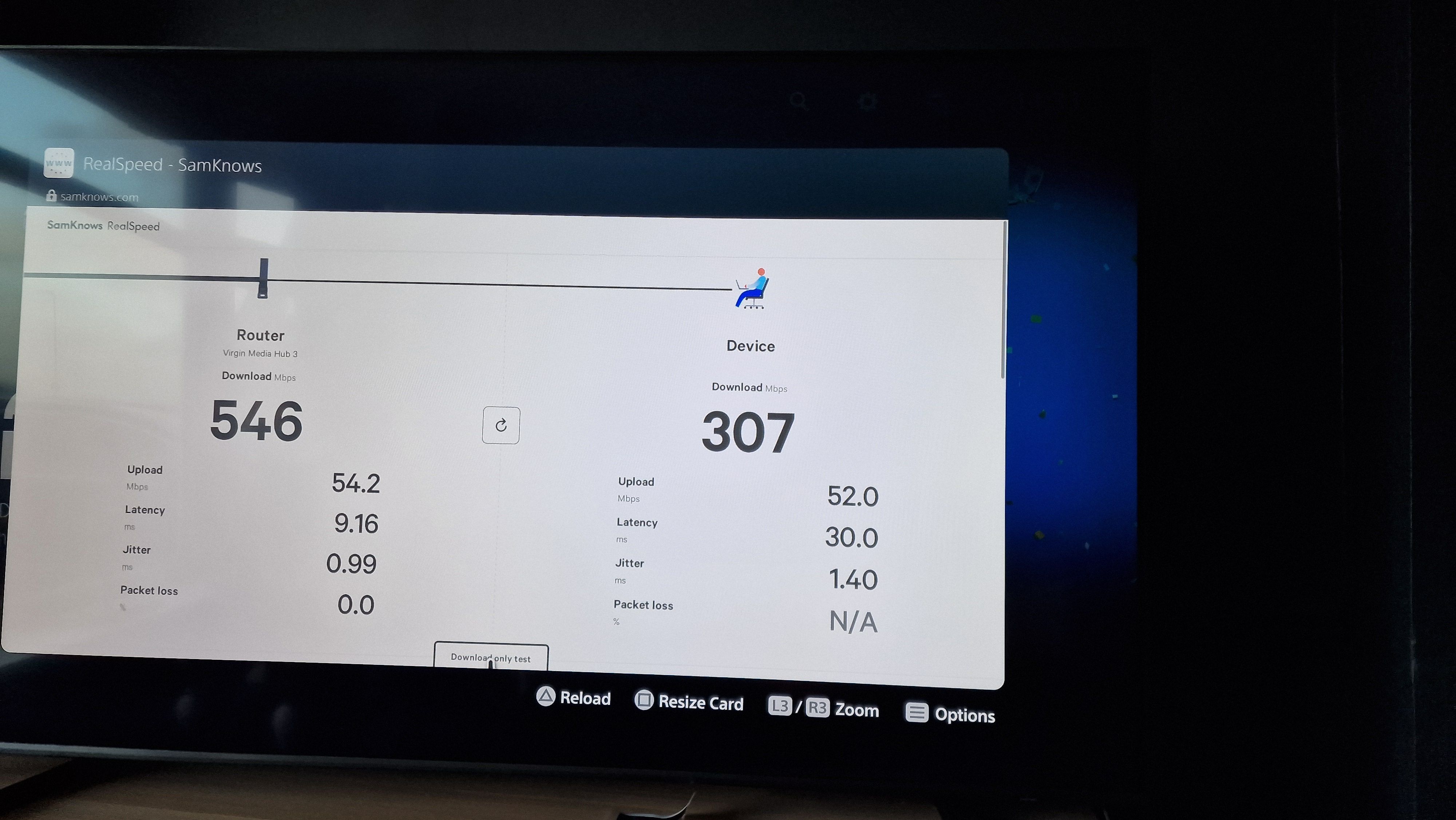

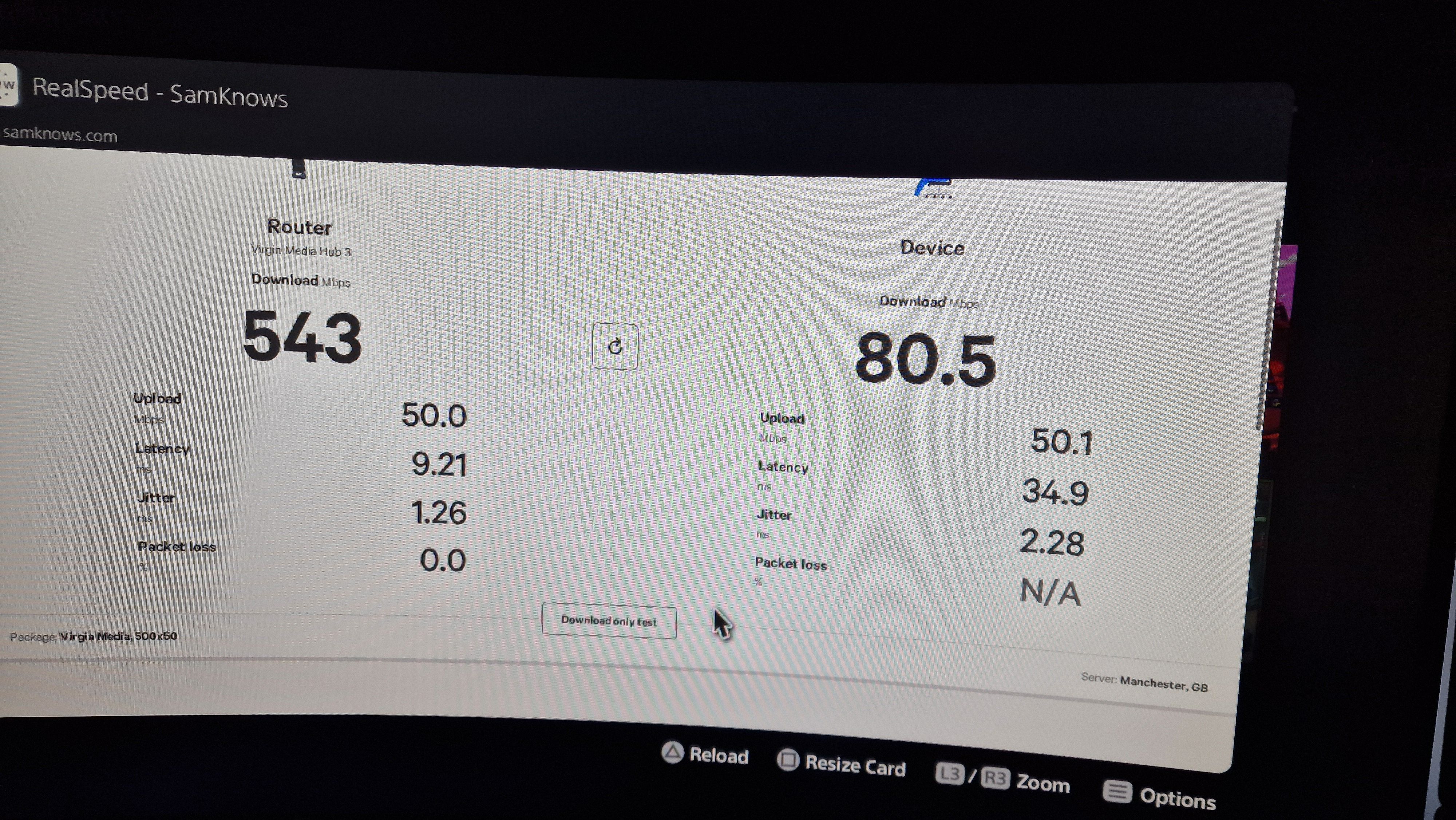

      • Longman's avatar
        Longman
        Ok managed it, took 2 pictures below the first is when my PS5 is plugged directly into one of my tp-link discs via ethernet and the other is ethernet cable into my VM Hub3
    So, your Hub is getting the full speed, but your PLA is the issue. Is it a Gigabit NIC ?  Or it could be the house wiring, but most likely the NIC.  As for the direct connection to the PS5, not too sure why you are not getting near the full 500.  Try another Cat 6 cable if you have one, and swap the ports in the Hub.

      Thanks, I tried new cable and port but the same results. I don't know how to check the NIC though, it's just a playstation 5, is that what you mean by PLA being the issue? Because when I run the Sam test on my mobile phone for example I get 446 download, 52 upload.
      Problem is that I don't want my PS5 in this room where my Hub3 is
        Yes, the picture of the TP-Link shows a speed that would be associated with a 10/100 network.   This is why I suspect the TP-Link is not up to the job.  Look at getting a PLA with Gigabit networking.
