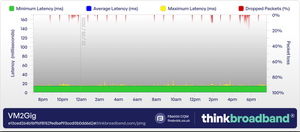

Hello. I have been with virgin broadband for about 8 months now and I have had nothing but an intermittent service. It is beyond frustrating as I have sky stream and suffer from streaming issues all the time. I have set up a broadband quality monitor since June and it clearly shows high latency issues and dropped packets all the time. I have had visits from two engineers that have changed the cables inside my property and outside but the problem persists. i have no idea what to do now and I am desperate for help. This BQM is a typical example of what I have faced daily since joining Virgin Media.621Views0likes24CommentsHub 5x, 2gig up/down - packet loss / latency / disconnects every 30 mins

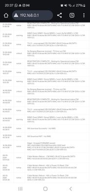

My Virgin 1Gig broadband is experiencing packet loss every few days for a few minutes each time. I'm running my Hub 5 in Modem mode and my Unifi UDR7 router records these incidents with exact timings. They usually though not always coincide with errors in the log of my Virgin Hub 5. I've added screenshots of the errors in the Hub 5 as well as general connection info in case there are issues with signal strength etc. I tried rebooting the Hub 5 and noticed there were some fresh errors following reboot so I've added screenshots of those too. Hopefully some of you smart folk out there can point me in the right direction for solving this. Apart from these intermittent dropouts my connection is working great!224Views0likes6CommentsHigh packet loss, Area 12
