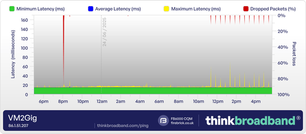

This is infuriating, any ideas what’s been causing this random packet loss?
im on 2Gig up and down, Hub 5x

    Unused connection all day, however it only shows on real speed samknows when doing the router side of the test, device doesn’t cause any packet loss on pingplotter

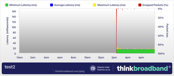

  • Exactly the same boat. 2gig up and down.
    this monitor has been running since friday, issues have been present about a week prior to that and still persist. £90 a month for constant drop outs is not the service i intended on paying for!
