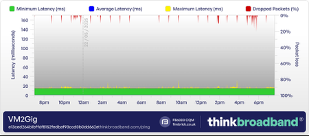

Hi, I seem to be having packet loss issues at the moment, very evident when playing online games, or running any test I will see the packet loss noted at around 3%. I ran my Hub stats into AI and got the following; Downstream Power Levels Range: from +3.7 dBmV (channel 11) down to +0.7 dBmV (channels 28-30) Ideal range for Virgin: -6 to +10 dBmV, recommended ±7 dBmV, best within ±5 dBmV Your levels are technically within spec, but the spread is about 3 dB across the band and they tilt downwards with frequency (lower frequencies stronger, higher frequencies weaker). The lowest channels are sitting at +0.7 to +0.9 dBmV – this is very close to the bottom edge of acceptable. Virgin’s own engineers often say anything under +1 dBmV starts to become marginal, especially if it drops further in hot weather or with temperature changes.2. Downstream SNR / RxMER 3.0 channels: 36–38 dB → perfectly fine for QAM256 (needs >33-34 dB minimum) 3.1 channel (OFDMA): the RxMER column shows “0” which is normal – it’s not reported the same way. The important figure is the PLC Power at +2.5 dBmV – healthy. No noise issues visible here.3. Error counters – this is the key part3.0 channels (QAM256): Almost completely clean – only a handful of Pre-RS errors on the very lowest frequency channels and zero Post-RS (uncorrectable) errors on any 3.0 channel. This is excellent – basically no packet loss coming from the 3.0 part of the spectrum. 3.1 channel (channel 159 – the high-split OFDMA channel that carries most of your speed): Corrected errors: 582,918,780 Uncorrectable errors: 0 That corrected number is huge – over half a billion FEC-corrected codewords. But crucially zero uncorrectables.What this means: The 3.1 channel is having to work quite hard correcting errors (likely because some of your downstream power levels are on the low side and possibly some ingress/noise on the higher frequencies), but the modem is successfully correcting everything before it turns into actual packet loss.So right now you are not seeing packet loss that reaches your devices – the hub is fixing it all at the physical layer. So it would seem that I am not getting any packet loss, however when you look at the thinkbroadband BQM you can see the packet loss. What can I do about this? Also my upload speed is currently around 22Mbps on the Gig1 plan.Solved683Views0likes24CommentsIntermittent broadband, latency issues, packet loss

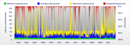

Hello. I have been with virgin broadband for about 8 months now and I have had nothing but an intermittent service. It is beyond frustrating as I have sky stream and suffer from streaming issues all the time. I have set up a broadband quality monitor since June and it clearly shows high latency issues and dropped packets all the time. I have had visits from two engineers that have changed the cables inside my property and outside but the problem persists. i have no idea what to do now and I am desperate for help. This BQM is a typical example of what I have faced daily since joining Virgin Media.634Views0likes24CommentsHub 5x, 2gig up/down - packet loss / latency / disconnects every 30 mins

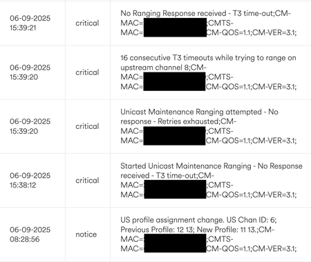

My Virgin 1Gig broadband is experiencing packet loss every few days for a few minutes each time. I'm running my Hub 5 in Modem mode and my Unifi UDR7 router records these incidents with exact timings. They usually though not always coincide with errors in the log of my Virgin Hub 5. I've added screenshots of the errors in the Hub 5 as well as general connection info in case there are issues with signal strength etc. I tried rebooting the Hub 5 and noticed there were some fresh errors following reboot so I've added screenshots of those too. Hopefully some of you smart folk out there can point me in the right direction for solving this. Apart from these intermittent dropouts my connection is working great!235Views0likes6CommentsHigh packet loss, Area 12

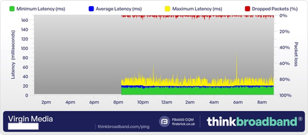

Hi, Since about February I've been experiencing very high latency in online games such as World of Warcraft (pings of up to circa 14k, huge lag spikes every couple of minutes and frequent disconnects which make gaming more or less impossible). I have started seeing similar issues with other online games recently too and websites where a connection is maintained (roll20.net for example) often lag out and take time to load. The issue exists for me on both wired Ethernet and Wi-fi and exists on 2 separate PC's in my house, one running Win 11 and one running Win 10. If I switch to a VPN, the issue resolves and I no longer suffer latency and lag spikes so I believe my home equipment is sound. Using a VPN permanently is not a viable solution however and I need this resolved. I have been running a BQM graph for some time posted here below but it doesn't indicate significant issues that I can see. I have also run traceroutes through both WinMTR and Pingplotter and the issue seems to consistently begin at a hop labelled "aor.uk-lon03a-ri1.network.virginmedia.net" where I frequently start to see up to 100% packet loss on the route to whichever server I'm trying to trace. I have had an engineer call out, he checked all my equipment and the local exchange on my street and confirmed all was working correctly and also ran tests from my pc to confirm the router is operating properly. The router has also been replaced about 6 months ago as I believed at the time that may have been the issue but the problem has persisted. I am on a 1Gbit plan with a Hub5. I do not use modem mode. Everything I'm seeing indicates a problem with the particular network hop so I'm hoping someone can take a look for me. <a title="Broadband Ping" href="https://www.thinkbroadband.com/broadband/monitoring/quality/share/bdca13531fcbaf42dd7fc257708c2371d258617d"><img alt="My Broadband Ping - Home" src="https://www.thinkbroadband.com/broadband/monitoring/quality/share/thumb/bdca13531fcbaf42dd7fc257708c2371d258617d.png" /></a> Thanks in advance3KViews0likes9Comments
