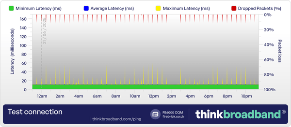

Hub 5x, 2gig up/down - packet loss / latency / disconnects every 30 mins
Hi, seems I am another victim of this disconnect and packet loss issue with 5x hub and 2gig fiber, which occurs every 30mins, which seems to be caused by 'RealSpeed' checking the speed of my connection (?!).
Can someone from support PLEASE stop this from happening to my service?
I need this resolved asap as I rely on the connection for WFH, competitive gaming and streaming with friends. The constant disconnects are making all 3 impossible to work with.

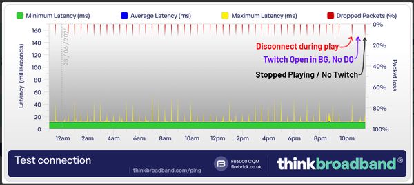

      Today's update (23/06/2025)
      • 12:00am to 9:30pm, At work and wasn't on PC until evening. Packetloss and latecy every 30mins as expected.
      • 9:35pm, Forgot to have Twitch open to test the theory and began playing Overwatch with friends as I usually would
      • 10:00pm, unsure why but no latency/packet loss here
      • 10:30pm, usual packet loss / latency spike and disconnected right on cue mid game
      • 10:35pm, I opened a Twitch stream which was using 400mbps (50MB/s) bandwidth and had it running in the background on a second monitor
      • 11:00pm, as expected no packetloss/latency spike. My theory is no automated speed test occurs when actively 'downloading'
      • 11:30pm, stopped playing just before and closed the Twitch stream. Right on cue the latency spike occurs
      I want to be clear this is NOT a 'solution' but seems like it may be a workaround for anyone else who games and gets these incredibly frustrating and unacceptable disconnects due to these automated speed tests. I will keep testing this theory to see if it's a reliable workaround even if ridiculous.

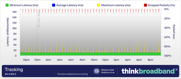

    29/06/2025 Update - Still the same issue! Virgin Media support email just said to restart router.
    It's so annoying, disconnects all my devices. PLEASE stop this.

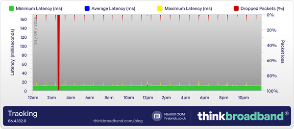

    5 MONTH UPDATE
    Whilst I did enjoy interruption free gaming and work calls for a period, the issue came back for me mid September.
    I thought I was going crazy or the new games I was playing were laggy - but I should've realised sooner the same issues was back.
    PLEASE VIRGIN MEDIA STOP SPEED TESTING FOR FAULTS ON OUR LINES
    WE ARE PAYING ALOT OF MONEY FOR 2GB UP/DOWN BUT DISCONNECTING US EVERY 30MINS - THIS IS INSANITY.

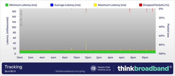

    Proof from my broadband quality monitor - 23rd of September when it was fine:
    Then the 24th September - look how awful that is, its not suprise I was lagging

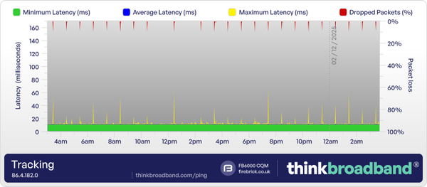

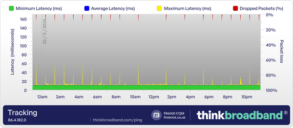

    This is STILL going today - here's an image from 20/11/2025
    PLEASE STOP THIS. This is unacceptable considering the cost.
    I am already past the 3 month 'testing' period OFCOM supposedly need - why is this even happening again?!

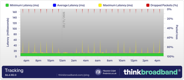

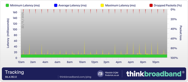

        Here's my Broadband Quality Monitor from 22nd November:
        And here is today, 23rd November 2025.
        It's every day on the hour.
        I want to re-iterate, this was already solved by the community support memeber (Akua-A) who contacted the company who test the XGS-PON lines and got them to stop testing the line (or at least, reduced it to 3 times a day). So the capability is there, it just needs to be sorted again.
        If you could help me sort this, it would be greatly appreciated. Apologies for the tone of the previous post, it is just greatly frustrating to have the issue return after previously having it solved.
