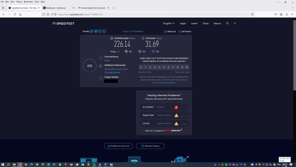

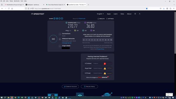

Test 1.  Speed Test via SpeedTest.net
I ran a “classic” speed test at https://www.speedtest.net.
Here is the result (23/05/2025):
The result is disappointing, given that I am on the M350 package.

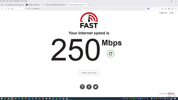

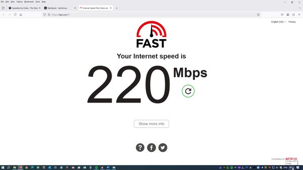

Test 2.  Speed Test via Fast.com
I ran another fairly rudimentary speed test at https://www.fast.com.
Again, the result is disappointing, given that I am on the M350 package.

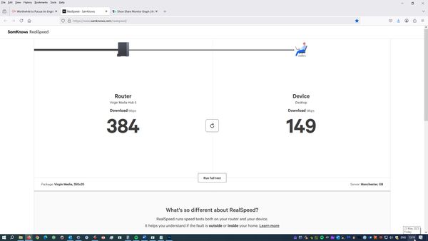

Test 3.  Speed Test via SamKnows.com/RealSpeed
I ran a SamKnows “real speed” test at: https://www.samknows.com/realspeed/
The result is disconcerting.
There is a very large disparity between speed to my router/hub, versus speed to my device.

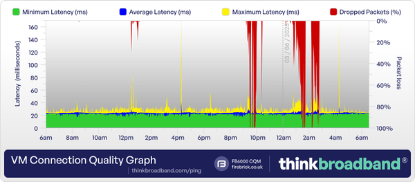

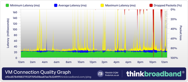

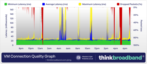

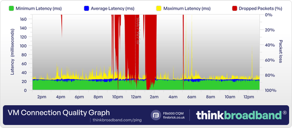

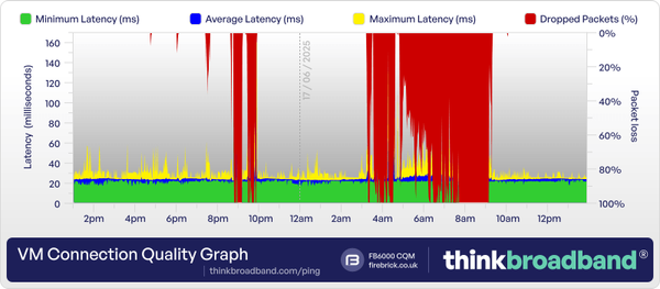

Test 4.  BQM (Broadband Quality Monitor) Snapshots
Here is the result for 22/05/2025:
Also, here is a link to my live and ongoing snapshot:
https://www.thinkbroadband.com/broadband/monitoring/quality/share/d57ddb32ce73f6c17be094e3b7602e5e1af7945d
There are some instances of packet loss, and some instances of latency creeping up.

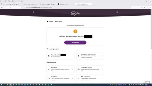

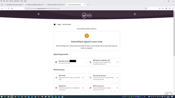

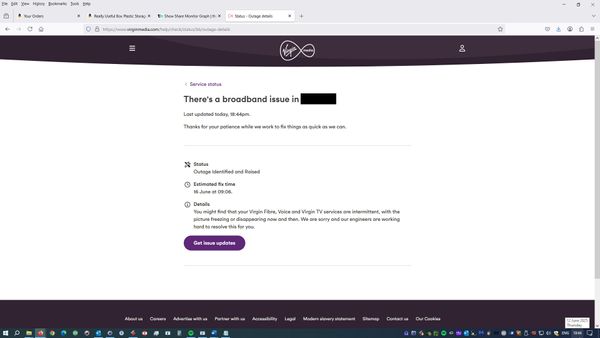

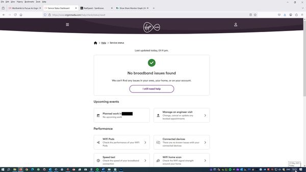

Test 6.  VM Web/Online Service-Status Check
I ran a service status check via my account page.
I believe this is the same check that can be performed without actually logging a VM account.  The publicly available check page is here:
https://www.virginmedia.com/help/check/status
Here is the result:
i.e., the result came back with an indication that there is an “intermittent signal in my area”.
I was invited to check back in circa 22 hours, with the potential option of taking-up a technician visit.

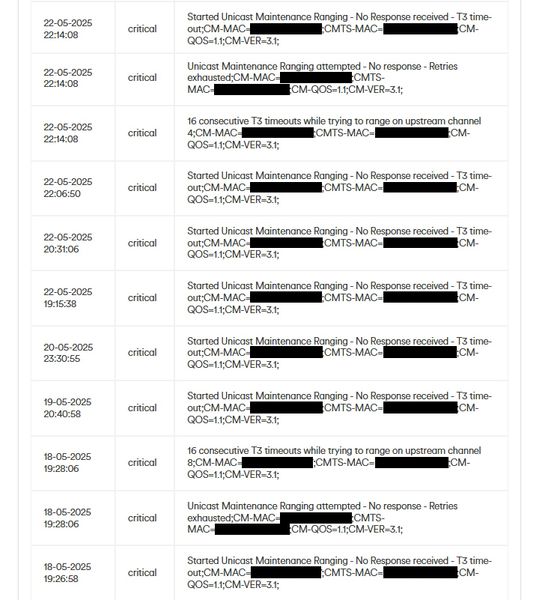

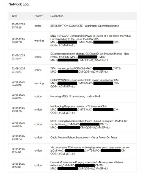

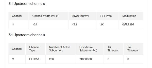

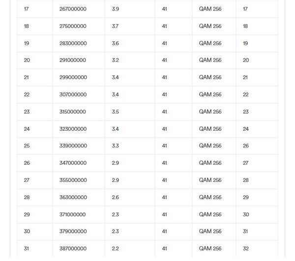

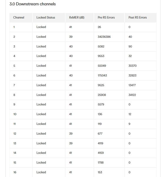

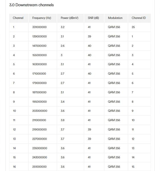

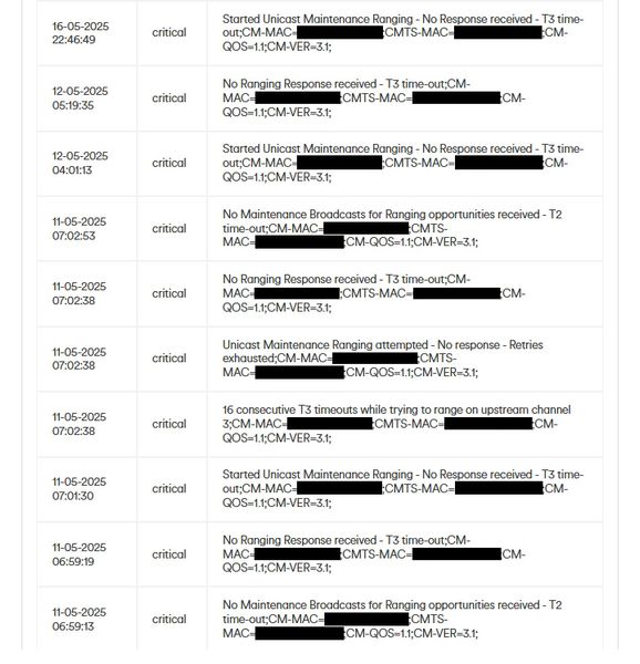

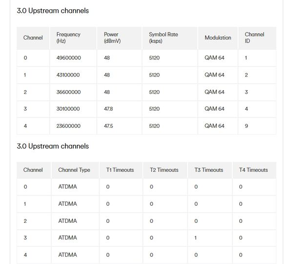

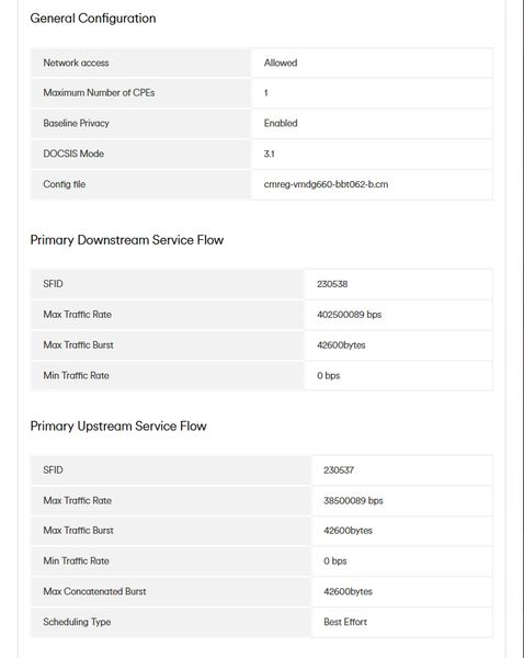

    Test 7.  Hub Diagnostics Review  (Status, Downstream, Upstream, Configuration, Network Log)
    I went into the Hub 5’s administration link (http://192.168.0.1), selected “Check Router Status” (no login required this way), then checked the following tabs/pages:
    • (7.1.) Status

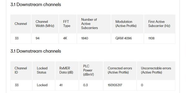

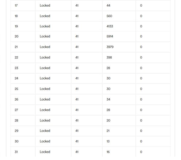

    • (7.2.) Downstream
    • (7.3.) Upstream
    • (7.4.) Configuration
    • (7.7.) Network Log

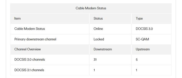

    7.1.  Status
    7.2.  Downstream
    7.3.  Upstream
    7.4.  Configuration
    7.5.  Network Log

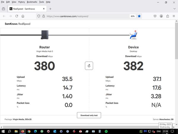

    The Samknows Realspeed test is the interesting one.
    The speed at the Hub is correct, at the computer the Upstream speed is ok too, but at the computer the Downstream speed is low.
    What is the connection between the VM Hub and the computer, is it a direct cable or is it a via Power Line Adaptors  (PLAs)?
    If it is direct cable - reboot the computer into Safe Mode and see if the Samknows Realspeed test improves - if it does perhaps a Norton or similar anti virus packages are degrading the performance.
    If it is via PLAs these could be limiting the speed.

      Ah, yes, I should have stated that the connection from my Hub to my desktop computer is via a Cat 7 network/ethernet cable, which, as far as I am aware, is "over the necessary spec" to get the job done reliably.
      To be more exact, I have been using a "1aTTack.de" brand 1.0 metre CAT 7 network/ethernet cable for some time (multiple years), with great results.  From my Amazon order history, the exact cable I bought (years ago) is still available here.
      In regards to the potential for an AV (antivirus, or similar) to be an issue, I had not considered that.  Thank you for drawing that to my attention.  Thankfully though, I don't actually run an AV, and I certainly don't run Norton!  So, I suppose a suite of this nature can be ruled-out as a factor.
      If I get some time later, I'll try the process of rebooting into safe-mode, then running the SamKnows RealSpeed test again, to check for any differences in performance.  Many thanks for that suggestion.
      Today's Performance Has Improved A Little
      Strangely, today's performance is a little bit better.  Web browsing performance feels much more snappy today, and pages seem to be loading properly this time.
      Here are today's tests/diagnostics, all of which are a bit better, but still not quite where I'd like the results to be for an M350 broadband service:
      Speed Tests:
      At 270 MBps, I'm still below where I'd like to be.
      Again, at 250MBps, I'm below where I'd like to be.
      The SamKnows identified speed disparity (Hub versus device [a desktop computer]) is still present, sadly.
      BQM (Broadband Quality Monitor):
      The packet loss and latency spikes seem to have calmed down a little.  The connection was performing very poorly at around 10pm to midnight last night, but seems to have settled down a little.  I feel there is still room for improvement in regards to the "latency spikes" however.
      No problems identified on this check today.

      Overall, it looks like the connection is a bit more stable today.  The only thing I undertook was a power off/on reset of my hub last night after a spell of very poor connection performance last night.  Outside that, all hardware is the same, and everything is seated the same.  It's a strange situation!
        I don't think this issue is the external connection to the VM Hub ( we can see that is OK ) or the network cable to the computer ( that is maintaining a 1Gb/s connection ).
        I strongly suspect the computer is not drawing download data fast enough.

    All things considered, I feel there are two ongoing problems regarding my connection quality.
    Problem 1:  My Device's (My Desktop Computer's) Connection Quality Does Appear To Be Inhibited Under Standard Windows Running Conditions
    As requested/advised by Client62 (thanks again!), I have now run the SamKnows RealSpeed test in Windows Safe Mode.
    As Client62 predicted, the test came back with zero speed disparity over the Hub versus my single connected device (a desktop computer).
    Here is a screenshot, taken on 28/05/2025:
    When using Windows 10 as standard, while I do not feel that I run any very obvious culprits that may degrade connection performance, I could perhaps, tentatively speculate the following might be factors:

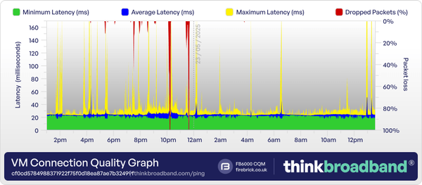

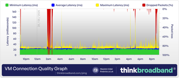

    Problem 2:  Packet Loss Still Occurring
    In addition, I am still getting what I feel are unacceptable instances of packet loss on a daily basis now.  It is negatively impacting my workflow and productivity, as there are moments when I have zero connectivity to the internet.
    Here is a Broadband Quality Monitor snapshot from yesterday (28/05/2025):
    As you can see, I had some bad moments at around 0200hrs and 2100hrs on 28/05/2025.
    I am hopeful that I can get a VM-side fix process started, perhaps with an engineer visit as part of that.  On the off-chance that this thread is being monitored by a VM forum colleague, I would be very grateful if they could start the ball rolling with that.

    Here is my Broadband Quality Monitor (BQM) snapshot for the past 24 hours (31/05/2025 to 01/06/2025):
    As you can see, the outage was from circa 2200 to 0200.
    My internet seems to be functional again thankfully.  (Whatever fix has been implemented appears to be ahead of schedule in its effectiveness, so many thanks for that.)

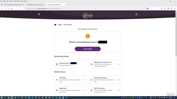

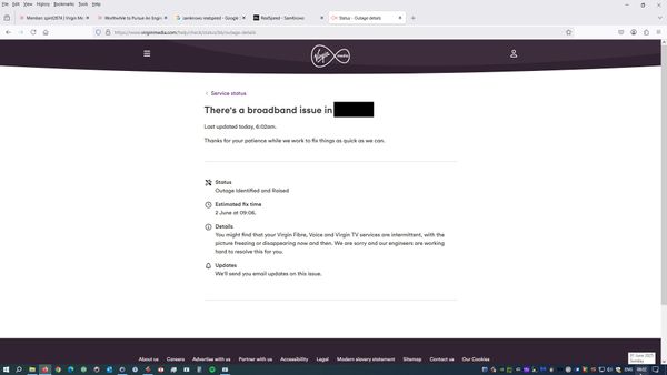

    For completeness, here is a screenshot record of the recognition of a broadband issue in my area (screenshotted on 01/06/2025):
    I'm hopeful that my connection stabilises over the next week, and that the instances of outages and packet loss diminish to zero.

    I've had a few moments of poor connection quality, but for the most part, I feel there has been an improvement in the quality of my connection today (04/06/2025), when compared to yesterday (03/06/2025).
    Here's a quick rundown.
    03/06/2025
    On 03/06/2025, I experienced some poor connection quality (and severe packet loss) at circa 0030 to 0230 hrs.  Here is a wee BQM snapshot to demonstrate:
    That was a little bit problematic, as I am going through quite an intensive phase of productivity tasks at the moment.  Still, it did resolve itself eventually by circa 0230 hrs.

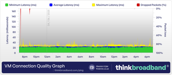

    04/06/2025
    Today (04/06/2025), things have been pretty good in terms of connection quality.  I have not noticed any instances of packet loss at all today, which is an improvement.  Here is a wee BQM snapshot to demonstrate:
    I'm hopeful that the engineer work (still in progress) can add even more stability to my connection.
    Once again, for completeness, here are some VM Service Status Checker pages (screenshotted on 04/06/2025) that show a problem is still identified as being active in my area, and that fixing works are still ongoing.
    So, overall, my connection looks to be improving (despite some blips), and I am hopeful that the engineer team fix further stabilises my connection.

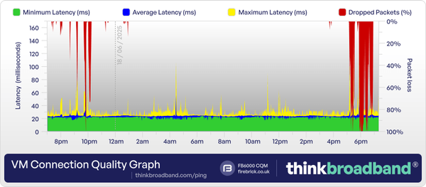

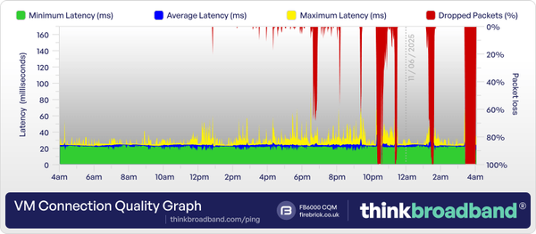

    Sadly, after a lull of "okay" connection performance for a few days, my "poor connection quality" issues have started back up again.
    Here are some Broadband Quality Monitor snapshots to demonstrate.
    10/06/2025, going into 11/06/2025
    12/06/2025
    Needless to say, from a "work from home" (WFH) perspective, this is extremely problematic, and causes me consternation and various professional problems.

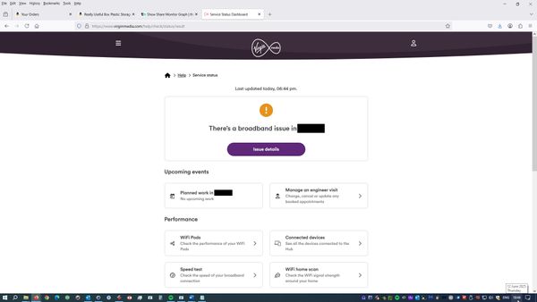

    I have checked the VM Service Status checker page here, and a fault is registered, with a fix date of 16/06/2025.  Here are some screenshots to demonstrate:

    • John_GS's avatar
      John_GS
      Good morning spirit2674
      Sorry you're thinking of leaving us.
      There is an ongoing intermittent issue in your area.
      F011854639 - fault number. The estimated fix date is tomorrow, 9am
  • Spirit,   While VM are sorting their network issues, you should probably check & clean browser clutter on your PC.    I have found similar Hub to Computer issues, especially when my browser cache has not been cleared for a while.   Try "ccleaner" free version & do a manual cleanup or cookies & history.   It should leave your bookmarks, passwords, etc intact.
    Your Samknows tests are exactly as they should be, so another PC test is to use the Speedtest Windows app instead of a browser to check performance.

    Sadly, I've had a poor run of connection performance recently, at what was quite an important time, and so, I've decided to draw a line under my time with VM.  Despite a fix to an issue that was estimated to be implemented on 16/06/2025, unfortunately, I had more outages that day and today (17/06/2025).
    Here is a Broadband Quality Monitor snapshot to demonstrate (17/06/2025):
    I've had a decent run overall with VM (starting with contracting with NTL), and for many years, had no pressing issues in terms of connection reliability.  So, I must give VM credit for that.  Recently however, the connection has not been performing well.

  • Hi folks.
    Hope all are well.  Just a quick update post.
    Regrettably, I am still getting daily outages, which can span multiple hours.
    To say the least, this is not ideal for work from home (WFH) purposes, or general productivity.
    Here is a Broadband Quality Monitor (BQM) snapshot to demonstrate today's outage (18/06/2025):
    As the graph demonstrates, today's outage spanned from circa 1700 to 1900.
    At time of writing, these issues have now spanned circa 26 days, at least.
    Sadly, I do not have a workable "mobile phone tethering" redundancy option at this time.  (That is something I am working on.)
    So, I am proceeding with a switch to a well-known OpenReach provider.
    A rudimentary glance at various relevant online forums (including Reddit) suggests outages are not wholly uncommon with VM, as of June 2025.  That is unfortunate, as my early experience of this network (spanning back to my early contracting, in my area, with "pre VM" NTL) was one of reliable provision.  Once again, I encourage a root and branch reappraisal, at boardroom level, of VM's current strategy on broadband provision, with an emphasis on 24/7/365 service up-time and reliability.
