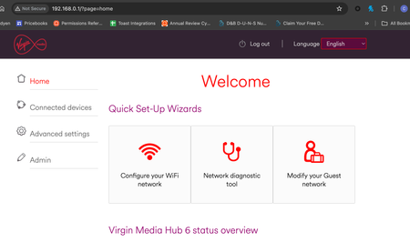

Hello Everybody, I dont seem to have the option for Modem Mode on my Hub 6 (Ireland), I have seen videos where it come as an option on the left menu but on mine it doesn't, I will attache a photo. Even if I go to Advance Settings or Admin there is no option for this. Has any of you seen a similar issue?, if so would you mind sharing what you did?888Views0likes5CommentsRandom resetting to Router mode (should be modem mode)
