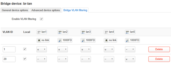

    The 360 must run on VM's network with a direct, unmodified LAN path for guaranteed performance. You should therefore create a separate SSID/VLAN for the filtered devices.
    Hub 5 (modem mode)
    GL‑iNet Flint 2 (OpenWrt)
            ├── VLAN 10 → “Clean LAN” → TV 360 box
            └── VLAN 20 → “Filtered LAN” → Everything else (AdGuard, VPN, etc.)
    • MrPegMan1's avatar
      MrPegMan1
      Thank you for the info, that helped.

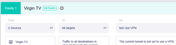

      The TV360 cable that splits to ethernet (Lan5 on router) and fibre/coax (tv box).
      Put Lan5 onto its own subnet separated from the other LAN traffic.
      To complicate things further I am using AdGuard and WireGuard, two of the main reasons for getting this router.
      WireGuard  - excluded the subnet from the VPN (e.g 192.168.5.0/24). Set the TV360 box to static IP and excluded that too.
      AdGuard  -  DNS is processing 'epg-prod-gb.gnp.cloud.virgintvgo.virginmedia.com' but I would expect that, just the guide. Using: 94.140.14.14, 94.140.15.15. 208.67.222.123
      I also created AdGuard device profiles for the MAC address of the TV box and then apply customer DNS of: 194.168.4.100, 194.168.8.100, 8.8.8.8
      Still getting service suspended.
        MrPegMan1
        Its WireGuard / VPN...
        Works when AdGuard and WireGuard off.  Also works with just AdGuard.
        also works when no internet.
        EDIT:
        As soon as i added the VPN filter correctly it works.  Think i need a rest, dangerous when tired!
        Some images for the other parts in case someone else hits this problem.
