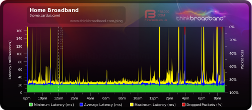

Hi,
Like quite a few others, over the past few months my Gig1 connection has been suffering from periods of high latency & packet loss.  This doesn't really affect streaming, web browsing etc, but it totally kills any kind of competitive gaming.
I've tried factory resetting the router, reseating connections etc.  Nothing's worked.  Does anyone have any advice?
Todays graph so far:

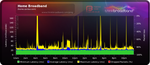

Yesterday:

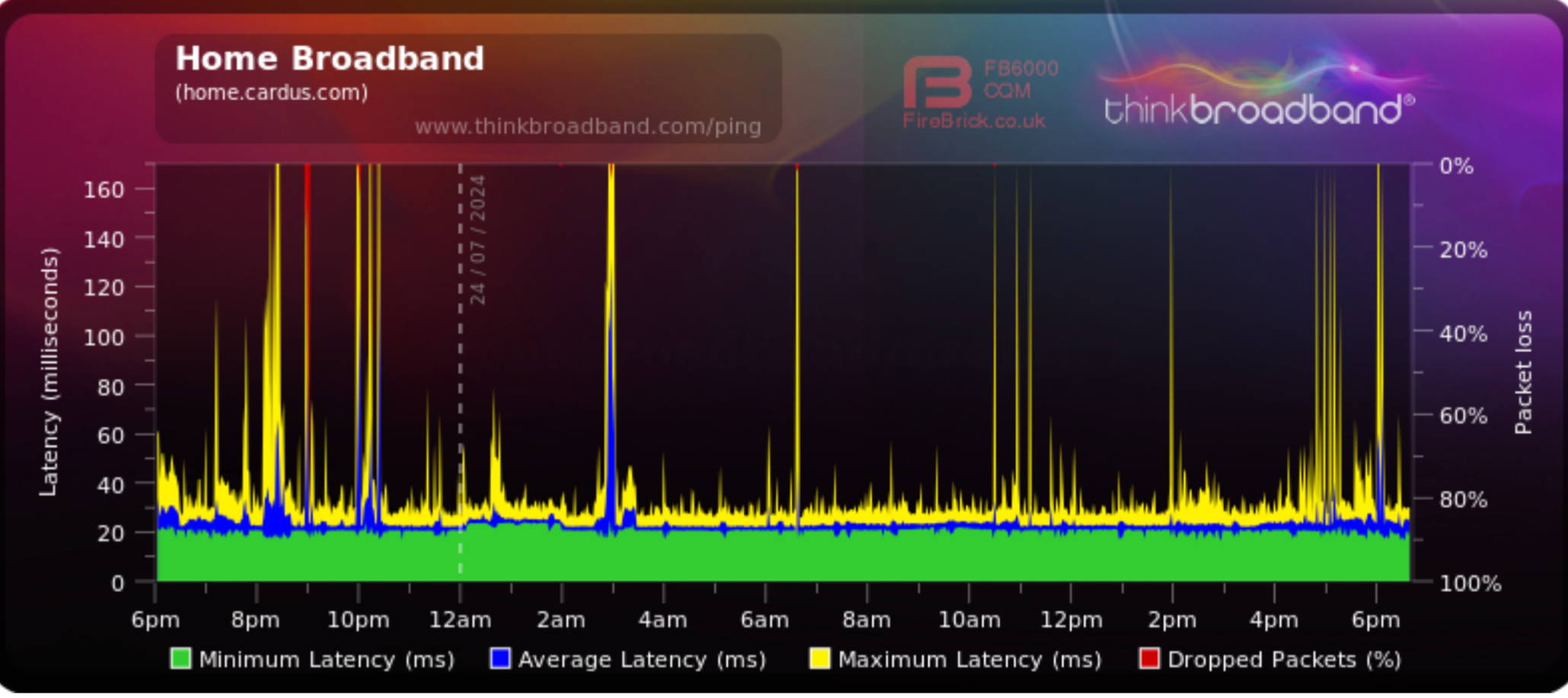

Saturday:

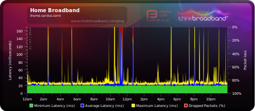

    The engineer came out yesterday, checked signal levels in the house, cleaned the fibre ends coming in from the street & also replaced my router.  Hasn't made much difference I'm afraid - still getting frequent periods of high latency and the occasional blast of packet loss.  Ignore the large red area between 2 & 4pm - BQM hadnt picked up my new IP after the router was swapped out...

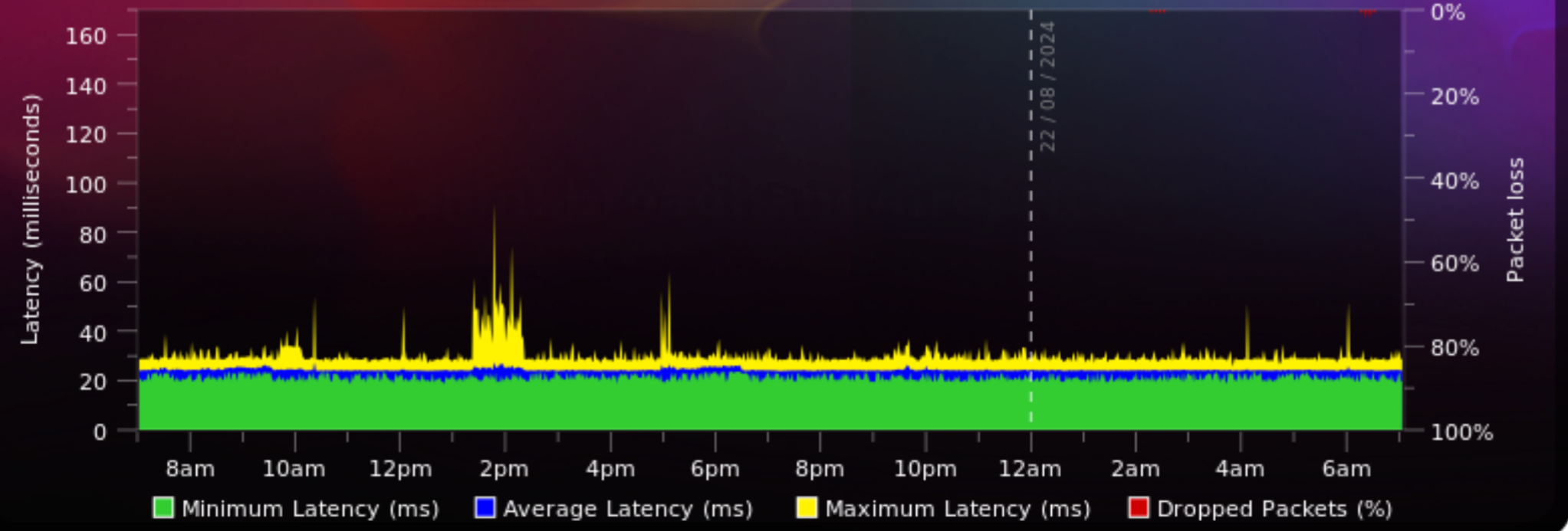

        Things have much improved since the weekend.
        It's been pretty stable with low latency and no packet loss since Sunday!
