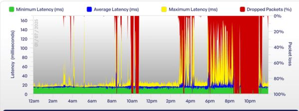

Intermittent connection
I’ve been having this issue for months where my connection is perfect for maybe a few days to sometimes over a week, then it will just completely disconnect for hours, for days if not weeks.
I’ve had an engineer come round, they replaced my hub with a hub 5 (originally a hub 3) which seemed great at the time but the issue just never fully went away. Done all i can to attempt to fix it, but realistically there’s not a lot i can do.
this is todays connection: https://www.thinkbroadband.com/broadband/monitoring/quality/share/42b53d2b86f43b5e4cb51298e5366c734a636424

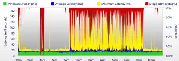

The above images are some of the worst days ive had but there have been only maybe 5/6 days like this so far (a majority of the time its just 20 minutes then its back for maybe 15)

    Bit of a pain for VM to track down if its not continuous.
    Try not to reboot the hub post up what T# times outs your getting from the hub if the count goes up over time.
    Might be someone in your area has a wrong cable and causing problem and might be only turning on the hub when they feel like it.

      Post count looks to be low so I give you a hint the problem is not wifi the BQM you see by the person post is to the hub if in router mode so this would seem to be a Docsis problem.
