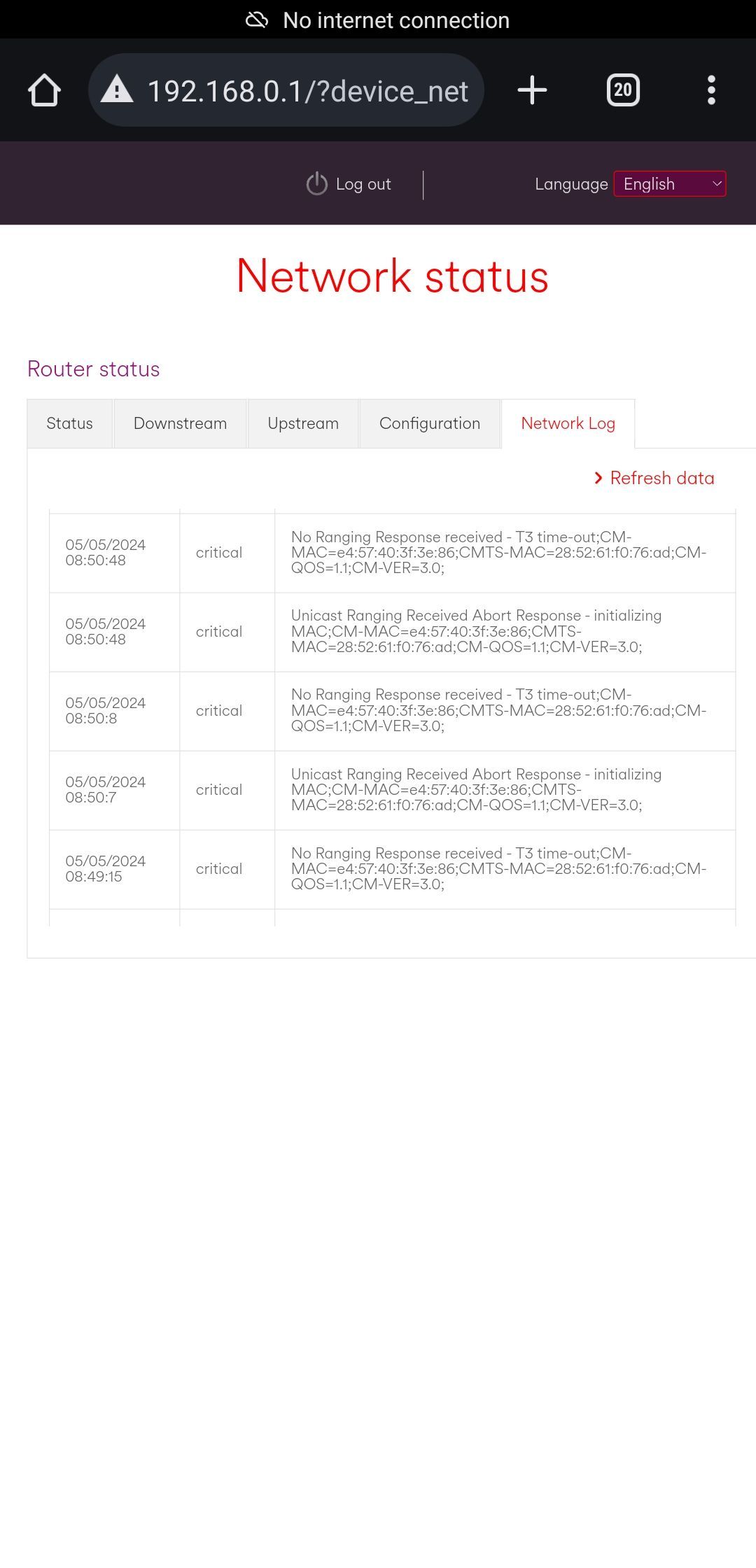

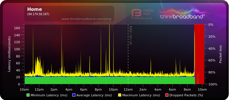

Hi,
I got 2 weeks ago a replacement hub from hub 2 to hub 3.
The internet was intermittent on hub 2 and that is why I got hub 3. The problem is still occuring. It is not WiFi issue, even on Ethernet the connection goes down. Network Status shows issues. I reset the hub after the initial installation.
Spoke to support and I got told that they are refreshing the signal to fix my problem. The problem is not fixed.
  • Looks like an engineer is needed - you can either wait a few days for a forum team member to respond or contact Virgin Media on X (@VirginMedia) or Facebook.
    Some of the downstream power levels are too low and you are missing 4 upstream channels. The upstream power levels are also very high.
8 Replies

      Downstream bonded channels
      1155000000-935256 qam3
      2139000000-9.734256 qam1
      3147000000-9.534256 qam2
      4163000000-9.435256 qam4
      5171000000-9.735256 qam5
      6179000000-10.434256 qam6
      7187000000-9.934256 qam7
      8195000000-1034256 qam8
      9203000000-1035256 qam9
      10211000000-10.734256 qam10
      11219000000-11.233256 qam11
      12227000000-11.433256 qam12
      13235000000-11.233256 qam13
      14307000000-12.932256 qam22
      15315000000-12.732256 qam23
      16323000000-13.432256 qam24
      17331000000-1332256 qam25
      18339000000-12.732256 qam26
      19347000000-13.831256 qam27
      20355000000-14.431256 qam28
      21363000000-14.531256 qam29
      22371000000-1431256 qam30
      23379000000-13.731256 qam31
      24387000000-14.231256 qam32
      1Locked3573381550
      2Locked34.434264871
      3Locked34.41134741215
      4Locked35138471511
      5Locked35169431368
      6Locked34.4459451168
      7Locked34.9118851178
      8Locked34.9173091144
      9Locked35107041258
      10Locked34.4319331252
      11Locked33.82702661095
      12Locked33.315615681054
      13Locked33.8179652662
      14Locked32.92788354610
      15Locked32.92750874398
      16Locked32.38574353264
      17Locked32.216511721164
      18Locked32.312622140145
      19Locked31.929244664431
      20Locked31.646151619883
      21Locked31.4648832411152
      22Locked31.6699082291296
      23Locked31.6541911551029
      24Locked31.491533339758
      • jaseclarkson's avatar
        jaseclarkson
        Upstream bonded channels
        12360000057512064 qam5
        1ATDMA0030

  • An engineer came in today replaced cables and splitters and something outside the house and the signal is better now. Thank you for your help.
