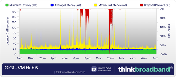

    • Kelly99_O's avatar
      Kelly99_O
      Just browsing
      Created monitor. Will post back in a few hours time with updated graph once we have some data.
  • For reference this happens at all times of day. This graph is not actually as bad to what I’ve previously experienced. It’s what I’d call a good day…
