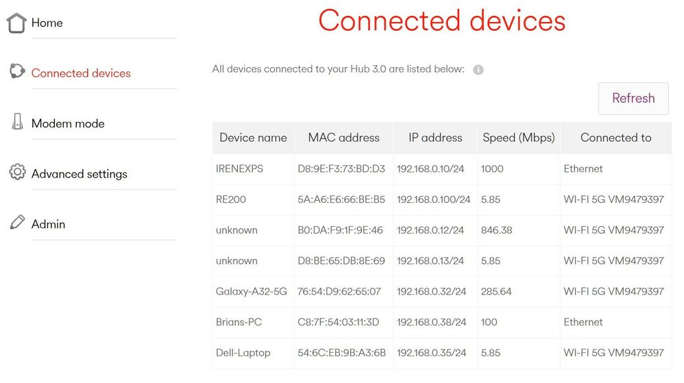

All connected devices are shown in the Connected devices page; 2x PCs connected to Ethernet and 1x Laptop connected to Wi-Fi plus Phone and other Wi-Fi connections (Tablets etc.)

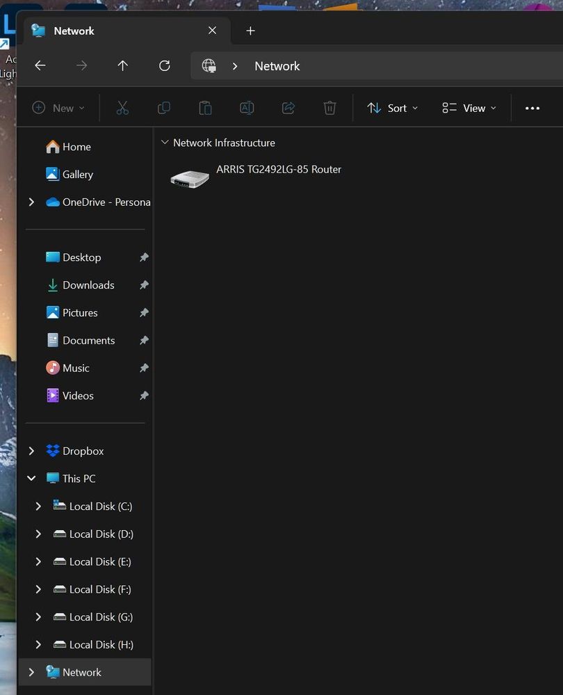

1x PC and the Laptop run Win11 Home, the other PC runs Win10 Home, the Win 10 PC can see the LAN but can't connect to the the Win11 PC or Laptop. The Win11 PC and Laptop can't see each other or the Win10 PC.
I've tried for years to get my LAN work - could it really be a Hub3.0 hardware issue? I've had others try to solve the issue.
When I click Network in the Win11 or Laptop this is the screen I get.

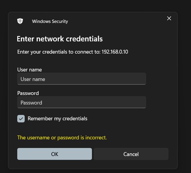

    If network shares are not showing up in windows explorer, try to access them manually...
    In windows explorer, type two backslashes then the ip address of the computer you are trying to access.
    If the computer's ip address is 192.168.0.51 type \\192.168.0.51\ into the address bar.
    What happens when you try to manually connect?

      Mapping the IP address I get to the Windows Credential screen.
      Now I've yet to find an proper step by step on how to use the Windows Credentials, I know where the Credential Manager is:
      Do you use the Web or Windows credentials?
      Are they unique for each LAN Connection?
      Do I need to find the Credentials for all LAN connections.

        On a home network the credentials are unique to each PC, log in using any username and password which exists on the target computer you are trying to connect to.
        I like to create a separate local user account just for logging into file shares.
