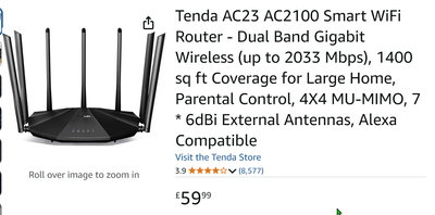

  • I purchased a tenda Router whioch I setup as a WiFi access point, my CCTV cameras operate at 2.4GHz, so I just use the 2.4GHz on the router for cameras only. It also supplies excellent 5 GHz WiFi topup as it is on the end of a 20 meter cat5e cable.
