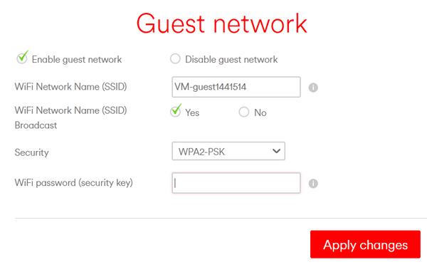

2.4Ghz on guest network
My hub 3 is set for 2.4 and 5 ghz but I only want 2.4 on my guest network. SSIDs I have OG and OGguest. How do I set this up please.

    You can't the hub is simple not advanced...in fact it should not even have guest network really
    get your own router that can use hub in modem mode
    What makes you think the Hub 3 Guest network is transmitting on 5GHz ?

    There are no 5GHz settings for a Hub 3 Guest network.

      Thanks for that. I did try it but it didn't work, I think it's because my phone will only connect the 5ghz signal. Cheers OG
        You don't mention what error you see trying to connect the mobile to the 2.4GHz band.
        My Samsung phone fails to connect on the 2.4GHz Wi-Fi band only if the VM Hub has elected to use Channel 13. ( we can see this in the Hub admin menu )
        After setting the 2.4GHz band to manual Channel 1 or 6 or 11 my Samsung mobile does  connect to the VM Hub on the 2.4GHz band.
