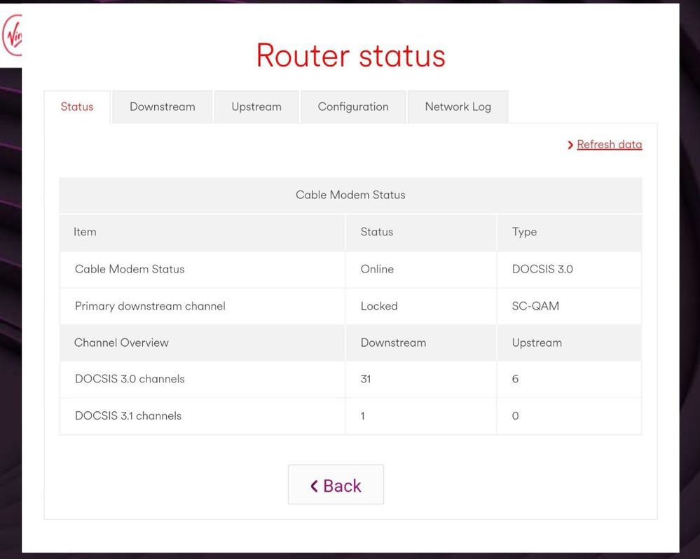

Hey all,
I posted this on the end of another thread but have had no response from VM so wondering if any of the community have opinions on this. Copied from my post:

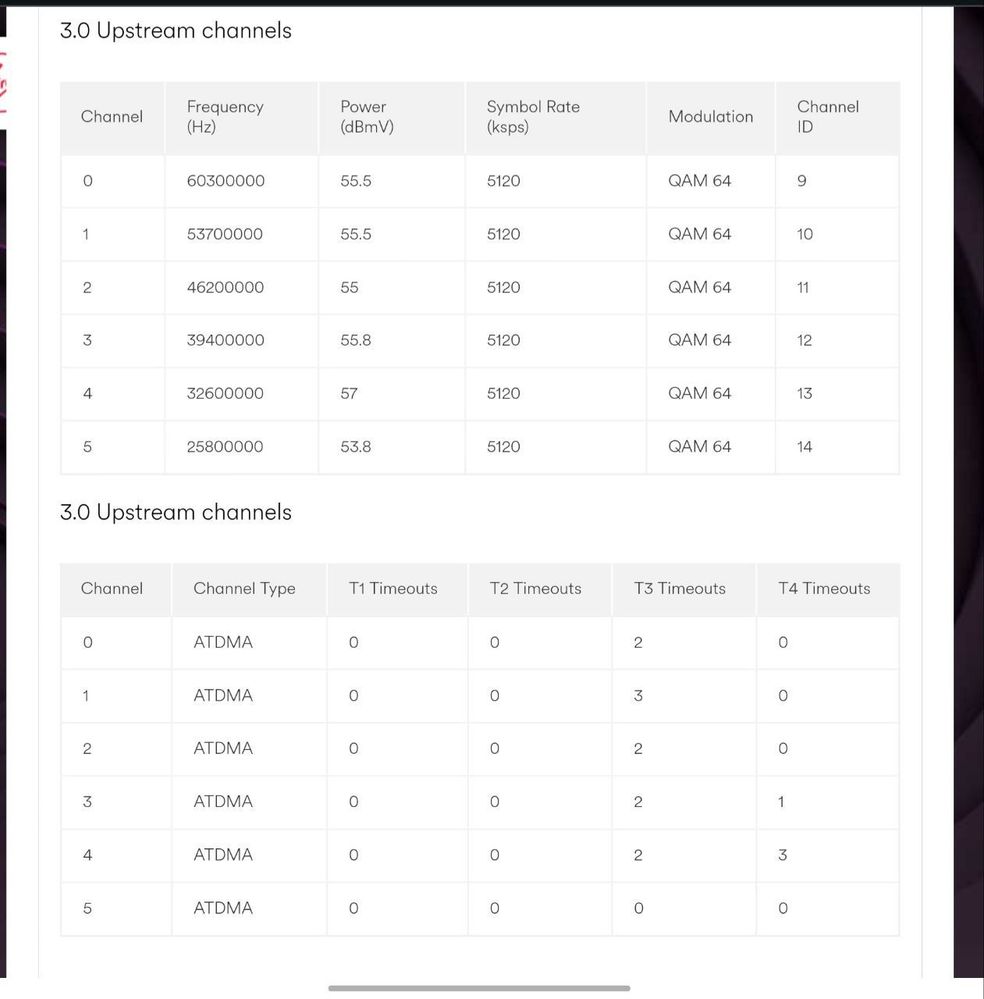

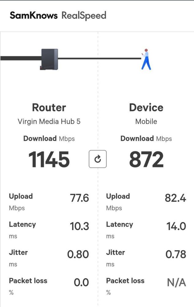

"I moved to a new flat with Gig1 and the flat has VM ports in 3 rooms. Looks like the other ports are fed by coax from the master port, I guess they were used for VM TV by the previous tenant. I have plugged in the cable feeding the bedroom port from the master port, and plugged the router in to the port in the bedroom, it works in terms of speed (the upload seems to struggle to get above 85Mb though), but I keep seeing random packet loss and noise on the BQM, especially when running speed tests.
Would you mind taking a look at my config to see if using this secondary port in the bedroom is OK? I haven't actually moved in fully to the flat yet so haven't been able to properly test it with online games or anything like that."

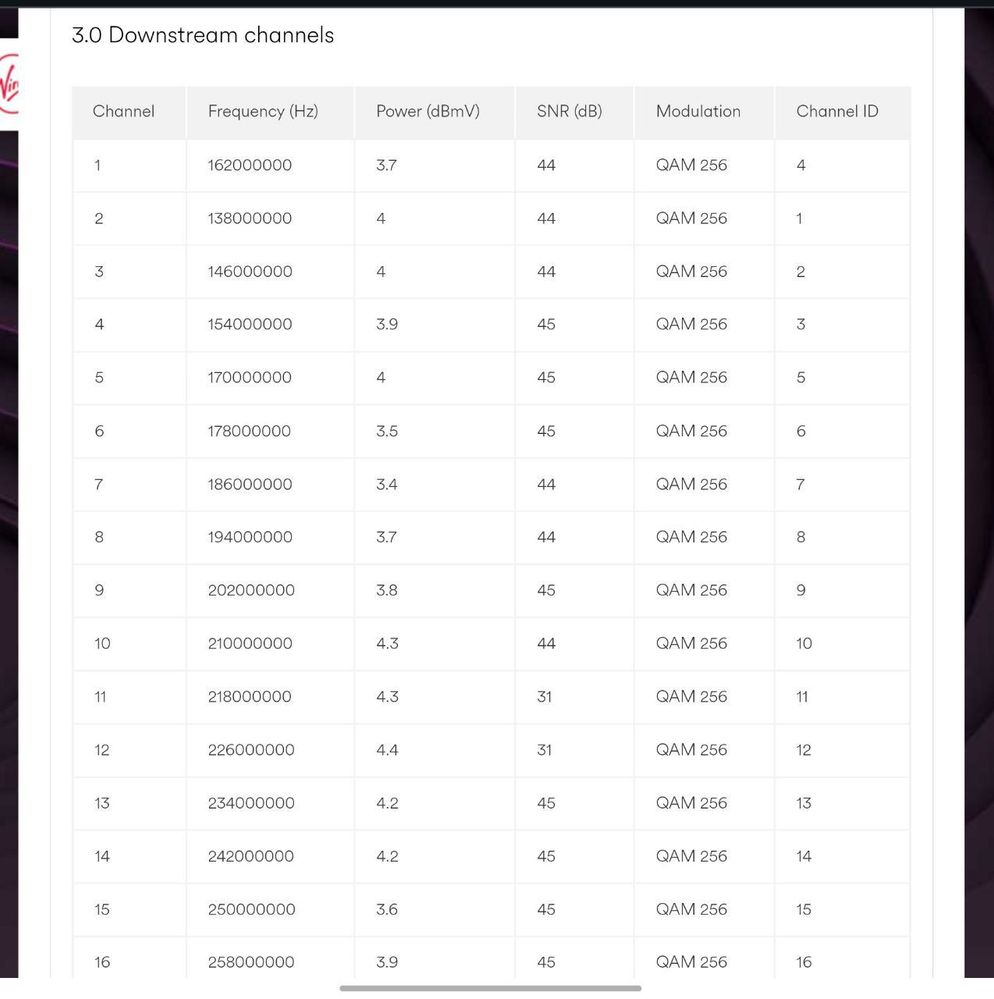

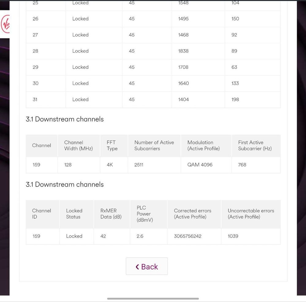

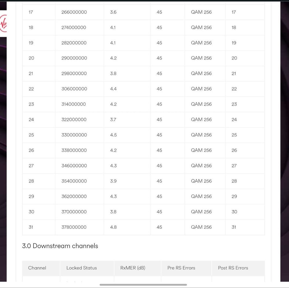

Power levels and such:
