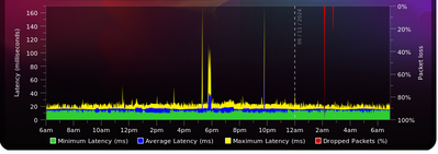

    • joloxx9's avatar
      joloxx9
      BQM from past 24HR
      Looks like there are some issues with it.
      • Carley_S's avatar
        Carley_S
        Keep us posted on how you get on joloxx9
        If you can post a live link to your BQM we'd be able to check this in real time rather than a screenshot.
