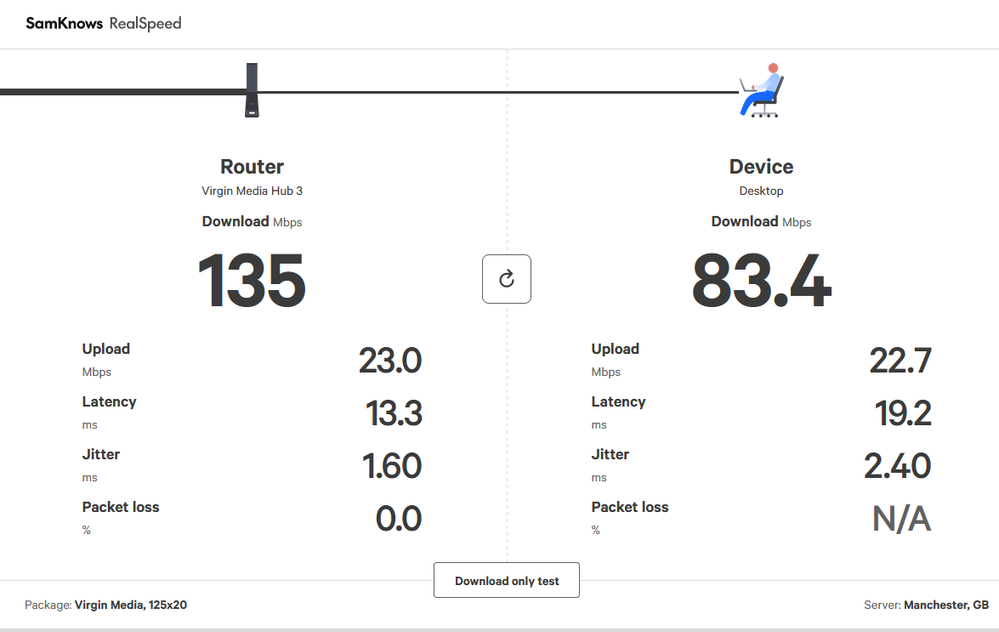

    The posted Hub connection stats are fine.   The error log, it is just like ours full of noise.
    Now test the service speed to the VM Hub and see how your device performs.
    Once the test begins click on: Run full test to see all the stats.
    • Johnnyboy123's avatar
      Johnnyboy123
      So is the only solution to buy a router and put the hub 3 into modem mode? Would moving the hub 3 closer to where I usually use my laptop improve matters?
