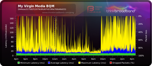

Network issues after engineer visit
I had an engineer come out today. He changed all of my cables and connectors, as I did had some really bad readings. He fixed those and put an attenuator on the box at the front of my house as he said I was having too high of a signal coming through. He left about 15:40ish
I was told my downstream should read about 7's where before it was on 11/12's.
It was okay for about 30-40 mins and now it seems even worse than before. I am a gamer, I am unable to enjoy anything atm, I pay for a good connection and speed. This is honestly the worst service I have ever had. If everything is okay at my property what the hell is the cause of this? Can I get some help?
https://www.thinkbroadband.com/broadband/monitoring/quality/share/e18e4e2305216a9f9889895ab93d8ffb57a01144-24-11-2023

    You got some bad jitter plus if the engineer did change your cables and such why does your BQM not show this?
    Do you use HomePlug - Network Via Mains?
    • Aedrothica's avatar
      Aedrothica
      I used an old BQM I just realise. My mistake, that being said no Docsis internet won't always be perfect but since having everything tested and cables changed, why am I still experiencing the same issues I had before the engineer visit today? This should not be happing on a daily basis ALL day every few minutes... I'm not kidding, gaming for 12+ hours the past 2 days and I have issues EVERY couple minutes this is not normal and should not be happening, and did not happen previously.
      Nope, no homeplug, I am using ethernet directly into the hub.
      I have set up a new BQM so I shall post results tomorrow once it has updated, I'm certain it'll be all over the place.
      So any response from VM once that is done would be much appreciated, because I am honestly sick of it, there has to be a reason for these issues to still be happening.

        Couple of things.. Switch the Hub off and unplug it from the mains supply for five minutes.  Then switch the Hub back on and leave ~5 minutes When all done, check back in the settings and ensure that the RS error counts and any T3 errors have all reset to 0. Then check every hour or so to see if they start reappearing - they shouldn't. If they do (particularly the PostRS and T3 ones) you have a problem.
        Secondly, what devices are plugged into the Hub on ethernet cables.?  I ask because there have been several threads on here recently where similar BQM latency/packet loss problems were eventually pinned down to a dodgy piece of ethernet connected kit affecting the connection . Bad connectors on ethernet cables and faulty network switches being high on the list of culprits.
        What I advised was... if you run the BQM for 24h to get a picture of the issues (you have done this) - and then unplug all the ethernet cable connections from the Hub and just let it run - overnight is best - then in the morning look at the BQM and see if it has cleaned up. If it has - plug the devices back in one at a time for an hour or two until the problem reappears and that should indicate where to look for what is causing the issues
        Examples.
        See message 21 in the first thread, 13 in the second and 5 in the third
        https://community.virginmedia.com/t5/Networking-and-WiFi/Internet-connection-dropping/td-p/4781287/page/3
        https://community.virginmedia.com/t5/Networking-and-WiFi/Intermittent-Connection/td-p/5069984/page/2
        https://community.virginmedia.com/t5/Speed/Issues-in-GU22-area/m-p/5400109#M307543

    Its not that hard to make anyone's BQM look bad with hubs and VM choose to not address it and yet they do other stuff like New Hub 5 Smart Security that we don't want!
    Test hub in modem mode to a PC or console
      Aedrothica
      I'm not sure why anyone would make their BQM look bad or make up issues though. I have a genuine problem I want to have fixed. Modem mode didn't seem to make a difference. I have now factory reset the hub.
