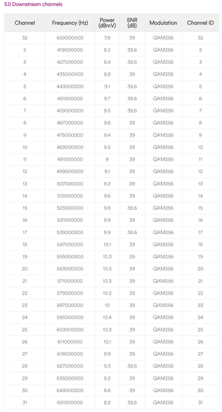

  • fungus1487's avatar
    fungus1487
    3.0 Downstream channels
    ChannelFrequency (Hz)Power (dBmV)SNR (dB)ModulationChannel ID
    326590000007.939QAM25632
    24190000008.238.6QAM2562
    34270000008.338.6QAM2563
    44350000008.839QAM2564
    54430000009.138.6QAM2565
    64510000009.738.6QAM2566
    74590000009.538.6QAM2567
    84670000009.738.6QAM2568
    94750000009.439QAM2569
    104830000009.539QAM25610
    114910000009.139QAM25611
    124990000009.139QAM25612
    135070000009.238.6QAM25613
    145150000009.639QAM25614
    155230000009.738.6QAM25615
    165310000009.839QAM25616
    175390000009.939QAM25617
    1854700000010.139QAM25618
    1955500000010.338.6QAM25619
    2056300000010.539QAM25620
    2157100000010.339QAM25621
    2257900000010.239QAM25622
    235870000001039QAM25623
    2459500000010.338.6QAM25624
    2560300000010.338.6QAM25625
    2661100000010.139QAM25626
    276190000009.838.6QAM25627
    286270000009.338.6QAM25628
    296350000009.139QAM25629
    306430000008.638.6QAM25630
    316510000008.238.6QAM25631
