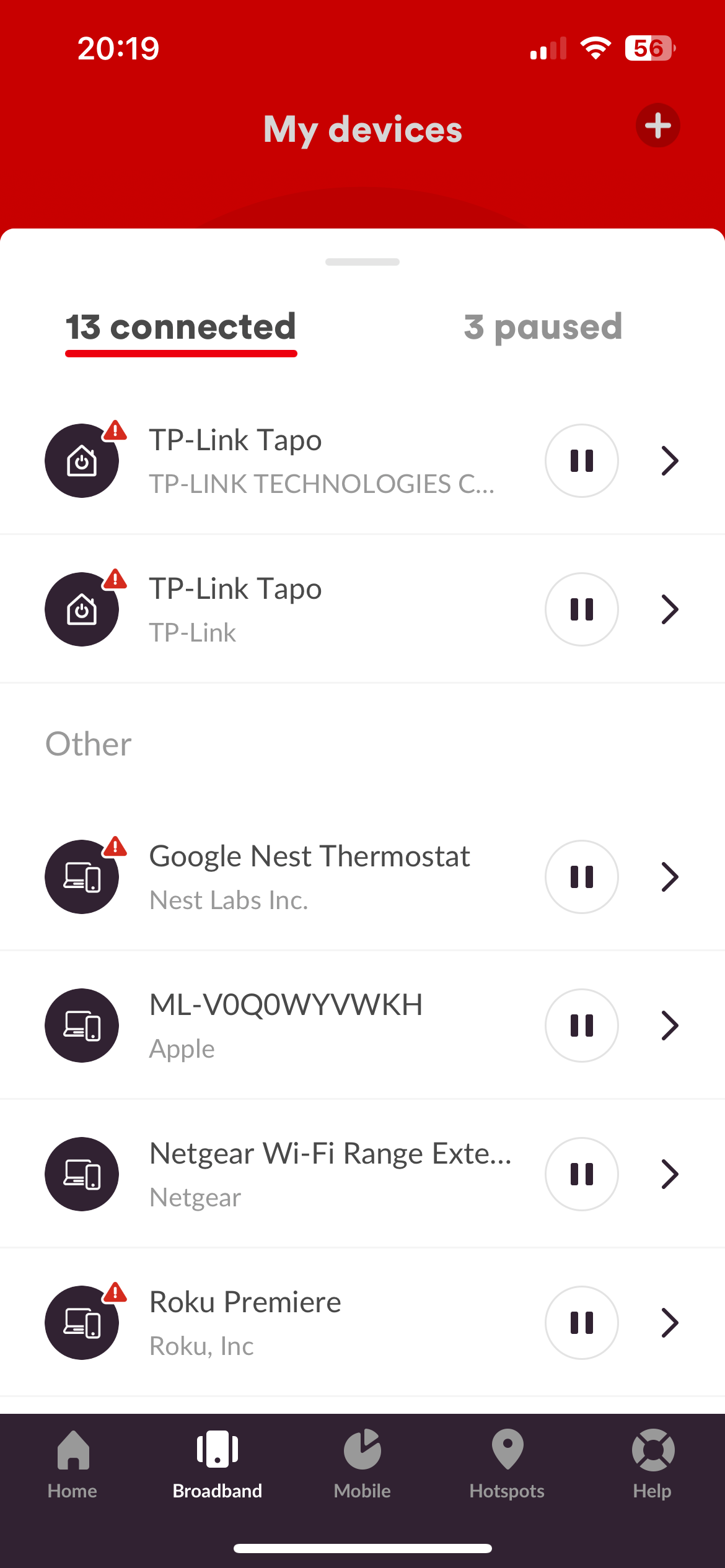

 Hello

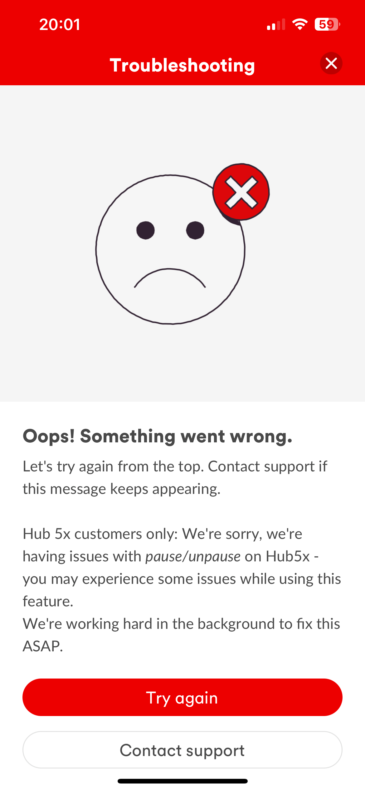

We have a recurring problem where the virgin app shows multiple devices have a poor connection with the red warning triangle. We have a Hub 3 and about 13-15 devices connected, but only every streaming from a maximum of 2 devices at once. Wifi speed seems fine on speed tests and the Virgin signal app shows good signal across the whole house. The vm connect app also keeps showing the “whoops something went wrong” page which I suspect is due to lost connection. Please help!

    Have you tried to reboot your hub and remove and re-install the connect app since the issues started?
    Have you ever been able to access the Connect App?

      thanks for taking the time to reply. I have tried rebooting and reinstalling the router and hub app but the problem persists. I finally managed to uncover Virgin’s phone number and got through to an engineer who essentially told me that I had too many devices connected. I had a maximum of 14 devices connected, though not all using high data. The virgin engineer said a maximum of 5 devices should be connected at any one time, which seems crazy. So at the moment I have had to disconnect some devices and seen an improvement. Apparently my only other option would be to upgrade? But that’s just not financially viable for us. The speeds we were getting were perfectly fine (no 4k streaming or anything like that in the house) but it seems the router just can’t cope with more than 4 devices connected? Do you think I have any other options? Should I just buy a better router? We are on the M100 fibre package.
