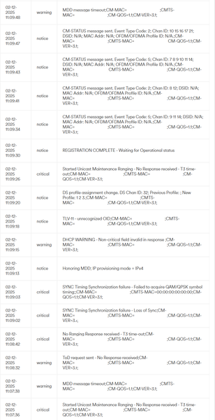

  • At random intervals (this can happen multiple times in a day, or not at all for days) my connection will drop. This typically shows as T3 timeouts (often on all consecutive channels) in the network logs. There is no pattern that I have been able to ascertain.

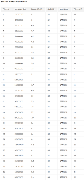

I can't put my finger on when the issue first started occurring, but there have been no changes to equipment or in the house since the connection was originally installed. After doing the usual troubleshooting and confirming there were no apparent issues on my end, the first engineer was sent out. The first engineer rebalanced the signals, as some of the power levels were out of spec. A check was also done on all of the equipment internally and externally. The problem still occurred despite this.

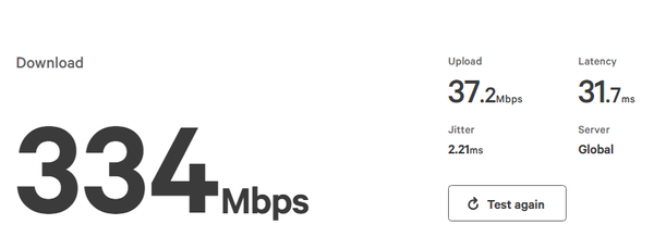

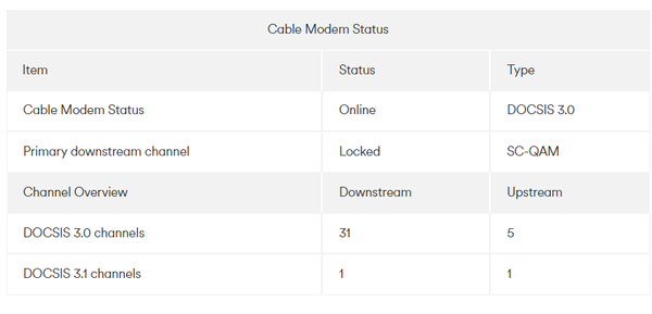

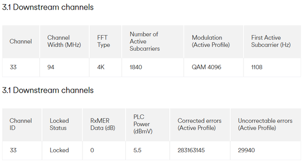

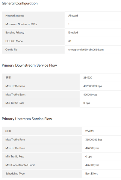

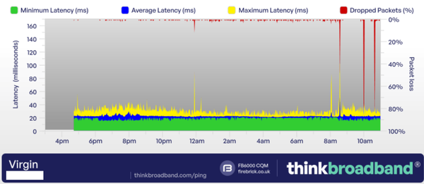

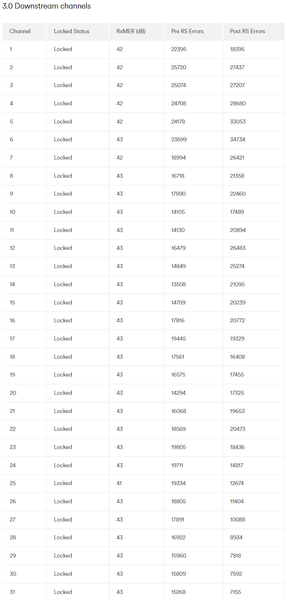

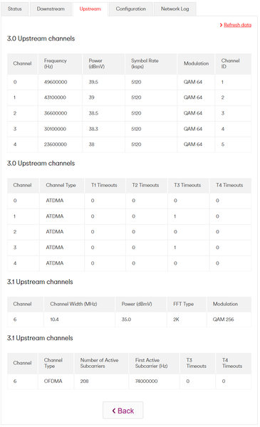

Ahead of posting this, I set up Broadband Quality Monitoring and waited for the issue to reoccur. This morning it has happened twice, which I believe is reflected there. I've attached images from today of an example of the issue in the logs, as well as the information from the router, the BQM and the results from SamKnows. Removed all IPs and MAC addresses in the images.
