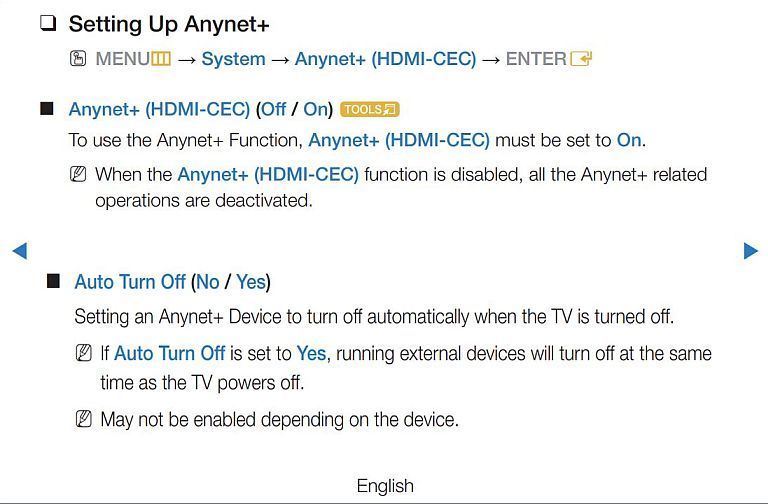

        I've googled the Samsung PS430450A2W and it seems that the TV is a little long in the tooth so the TV may not be in the 360's remote database. According to this  /samsung/support/model/PS43D450A2W page, the TV was first out in March 22nd 2011 and hasn't received any updates since 11th December 2013.
        It does however have Anynet+ which is Samsung's equivalent to HDMI-CEC which allows connected devices to talk to each other through HDMI, so if it's turned on on the TV it might enable the TV and 360 to recognise and talk to each other. So if all of the above fail then I would try turning on Anynet+.  See screenshot below for instructions on how to enable Anynet+ on the TV.
