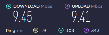

  • Hi sorry for the late reply, It did settle down, however it's back to being dodgy again. Im currently getting 9 mbps upload and download on the router, after a restart and a reboot.
    Wired connection to both computers.

    • carl_pearce's avatar
      carl_pearce
      Superstar
      Just under 10Mbps up and down is suspiciously close to ethernet running at a VERY low link speed (1Gbps/100Mbps/10Mbps).

  • Hi, So iv replaced both ethernet cables.
    pulling in 470mbps on one machine now and 411mbps on the other with the routers speed reported as 534 mbps.
    both machine's and the router/hub had to be restarted to get those speeds however as they were caping out at 90.
