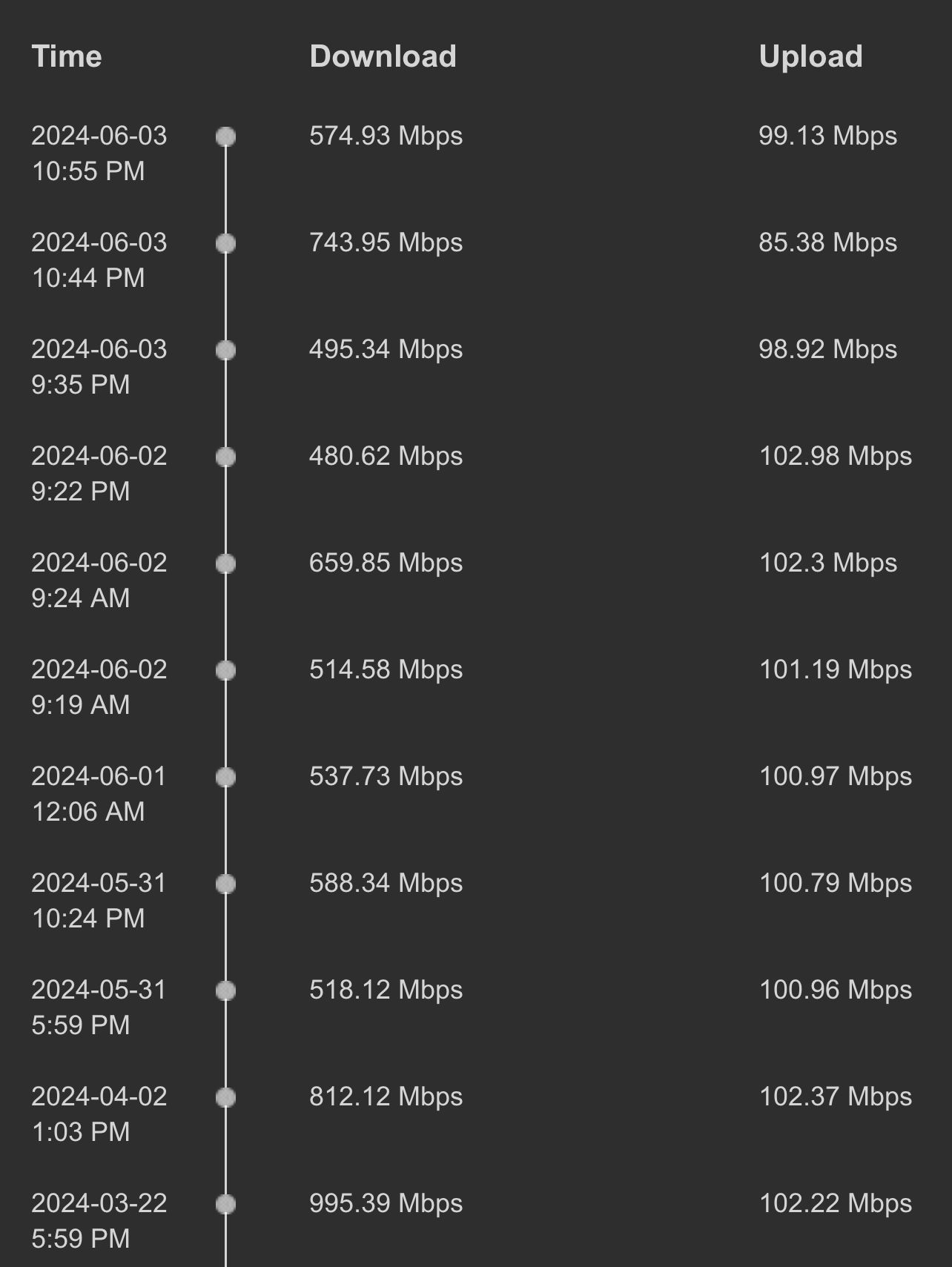

Speed halved after team messed with PEDCAP
Hi All,
Last week a virgin team turned up at the end of our street, they were in the ducting and pulling out the PEDCAP’s under the street and in the green cabinet, which they failed to close properly. I will assume to fault find. I noticed when they left that the speed to my router had halved from nearly 1GB to around 480Mb. I have tried resetting the hub and it has made no difference, the in app guide just keeps telling me to rest the hub, but I really do not believe that to be the issue. Can anyone help please?

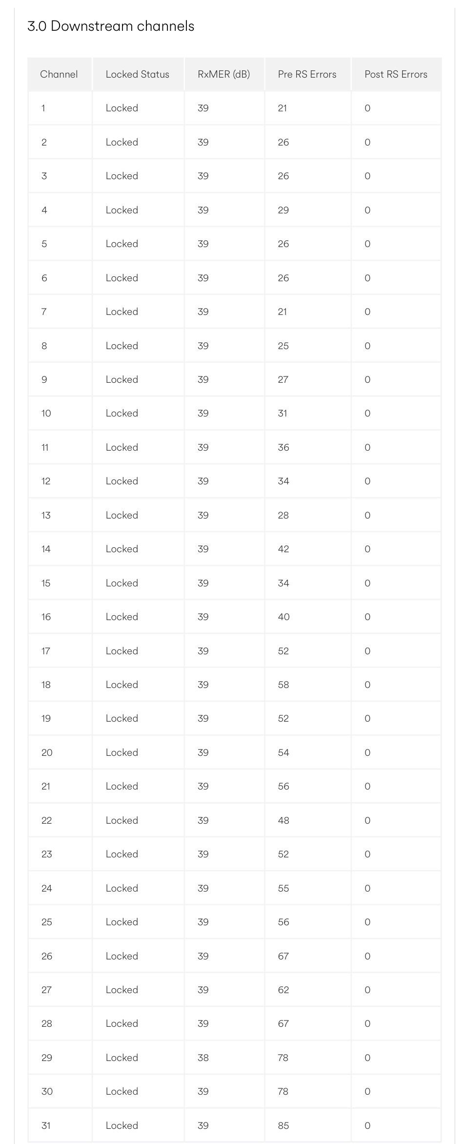

      3.0 Downstream channels
      1Locked395619
      2Locked396814
      3Locked39700
      4Locked39780
      5Locked39851
      6Locked396113
      7Locked397019
      8Locked396119
      9Locked397013
      10Locked39790
      11Locked39660
      12Locked39880
      13Locked39814
      14Locked399614
      15Locked391139
      16Locked3912510
      17Locked391210
      18Locked391370
      19Locked391370
      20Locked391390
      21Locked391431
      22Locked391481
      23Locked391762
      24Locked391580
      25Locked391641
      26Locked392022
      27Locked381923
      28Locked3821814
      29Locked3827919
      30Locked3924415
      31Locked3925816

      • Tudor's avatar
        Tudor
        Too many errors, but the figures are accumulative since the hub was last power cycled. So please turn off your hub for a short period, this will reset the counters, then post a new full set of stats after about two hours. This will indicate the current line status.
