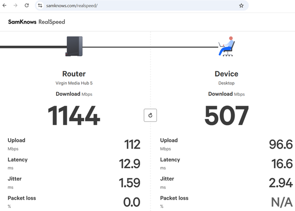

        I had an excellent engineer visit this week who replaced the router and demonstrated the full Gig speed on SamKnows. No more Post RS errors showing! I am able to get close to the Gig on Hub WiFi6 on my phone.

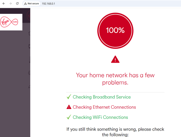

        However, the LAN ethernet connections are still half-speed for no reason I can determine. Running the 'network diagnostic tool' on the hub 5 web interface shows a problem on ethernet connections (screenshot below).
        Would appreciate any help! I use ethernet for work, gaming and a mesh wifi system ... none of which are getting the full bandwidth that the Hub is seeing :-(
        SamKnows Realspeed with laptop on CAT6 cable to hub:

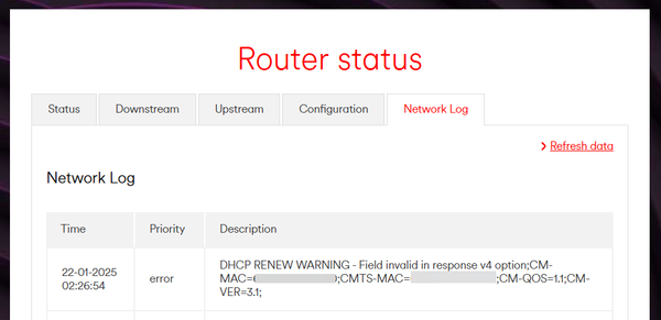

  • I also see the following error in the Network Log - perhaps related?
    DHCP RENEW WARNING - Field invalid in response v4 option;CM-MAC=***********************;CMTS-MAC=***********************;CM-QOS=1.1;CM-VER=3.1;
    • Molly_T's avatar
      Molly_T
      Hi Co_olin 👋 thanks for coming back to the thread to keep us updated!
      Glad to hear the engineers appointment mostly went well, and they were able to help get some of the issues with your speeds sorted. Would be interested to know if the Ethernet issue was happening with the hub before the engineer attended, and if they tested for this during the appointment?
      It sounds as though there may be an issue with the ports on the hub itself. I'd like to investigate further and help get this sorted. I will send you a PM to confirm a few account details and offer support. You can find the PM in your Inbox ✉ in the top right corner of the page. We can then return to this public thread with another update when possible.
