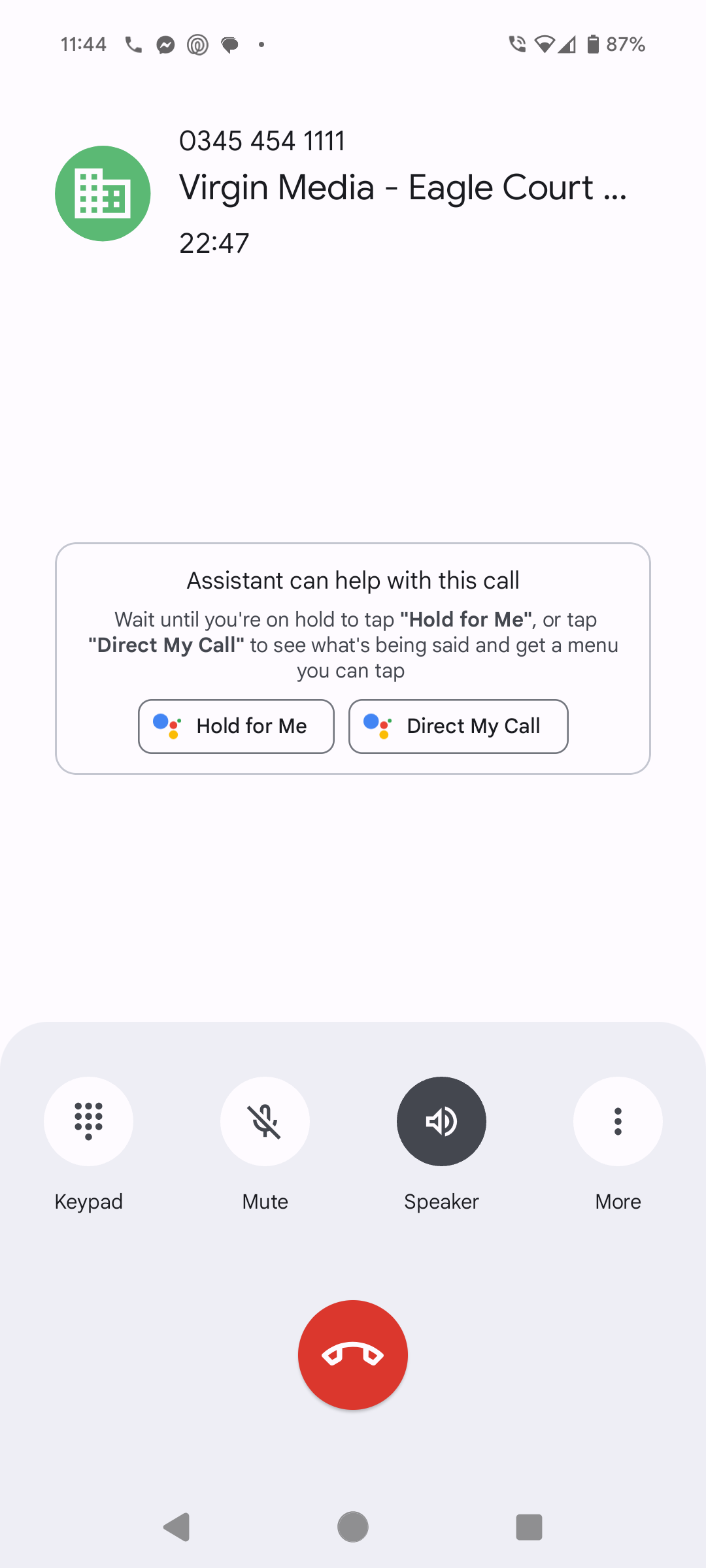

Has full fibre installed in the last few weeks.  In the room the box is in, the signal is great...leave that room however and connecting is a near impossibility.  I raised this with the engineers before they left my house who said if it didn't settle then it'd be easy to get WiFi pods to boost the signal to the rest of the house later.
I've now been trying for about a week to make contact with virgin support to seek a resolution, in fact I'm currently on hold
 Virgin are by some margin, the most frustrating company I've had the displeasure of trying to deal with (I say trying because I'm still waiting) in the last few years...
Any tips from anyone else on how I might be able to speak to someone who can actually offer some assistance.
