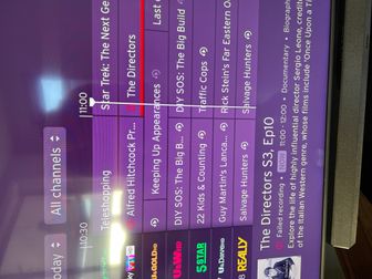

    Thanks.  I did migrate some months ago to 360 and the problems seems to start after then.
    The lounge Tivo 360 will not record anything which is live or scheduled.  It says "Sorry, we couldn't do this for you. Please try again later" - See attached screen:
    I've also performed several resets on this box but it does not seem to resolve the issue.

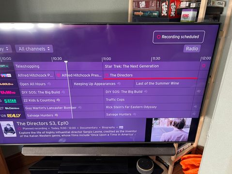

    I've tried to record a future programme event and it says "Recording scheduled" - See screen grab:

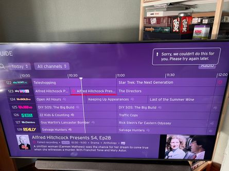

    but after waiting for the recording to start it says  "Failed recording" - See screen grab:
    This happens to all recordings.  The other tivo 360 box does seem to record now and again but its intermittent and unreliable.  Also the front indication panel is lifeless with no lights to indicator if its working or not.
