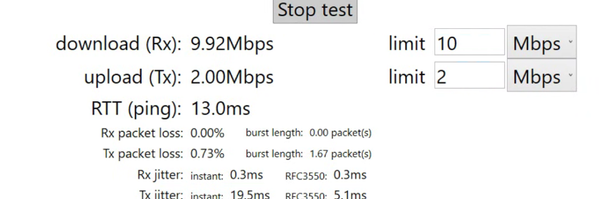

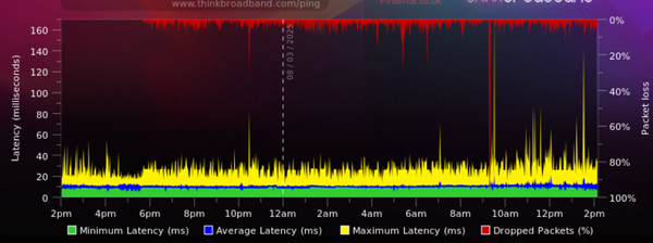

Since 6pm yesterday, my internet has been dropping packets according to the BQM. Also the upload speed is fluctuating and unreliable.
This is the Continuous Bandwidth Tester results:

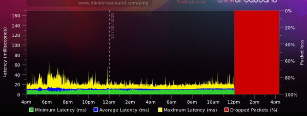

    Latest update is that I received a text message saying that the fault outage issued had now been fixed. However, I still have no internet (since just after noon):
    • legacy1's avatar
      legacy1
      your BQM till the red block showed fine so I don't get why your not connected...
        Maybe the fix has issued new DHCP scope to the CMTS and the BQM is wrong?

    downstream power levels are fine the problem as shown on StarTrinity CST is upstream noise
