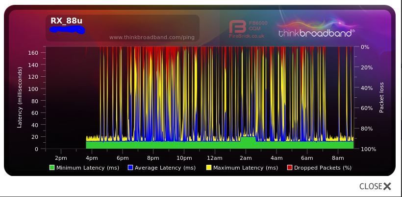

Hi all,

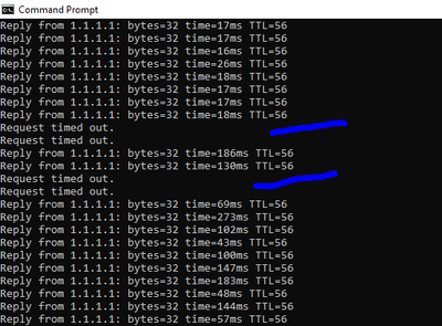

been with VM for nearly 2 years and this issue only began recently,  Basically total loss of connection (wired and wireless) frequently occurring, you can see this in basic ping test run in windows CMD. i have a VM hub 3.0
I have engineer coming tomorrow but just wanted some advice that what i am seeing is not correct. below are my UPSTREAM, DOWNSTREAM and NETWORK logs and also my thinkbroadband monitor graphs. I should also point out i am in Modem mode and using a ASUS router. I have several ASUS routers and changing the router or actual VM Hub 3.0 as router makes no difference to the issue

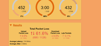

    Upstream power is too low, should be above 34.  Also a lot of PostRS errors, there should be ideally zero.  Possibly a fault in the area?

      those online tests only last a short span of time, and the fault is not always occurring as you will see from my think broadband graph. My own Ping test  run in CMD will show no packet loss for a while but eventually they will loose connection.
      This is seriously affecting streaming services and video calls

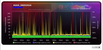

  • Hi all, The engineer (great guy really helpful) swapped out our hub 3 to a hub 5 and while things have improved (drop outs not as frequent) they are still happening and this is not acceptable for the service we are paying for.
    I have tried the Hub 5 in router mode and Modem Mode and in router mode the problem is slightly better but still not acceptable,
    I am tempted to think of saying unless this fault is resolved i want my contract cancelled and i will go to an openreach provider.  i am calling up again monday. Any Virgin company reps here i would really like to hear from you.
    my latest think broadband graph.
