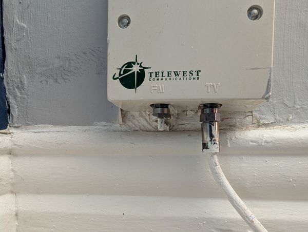

Router set up with old telewest box
Hi everyone,

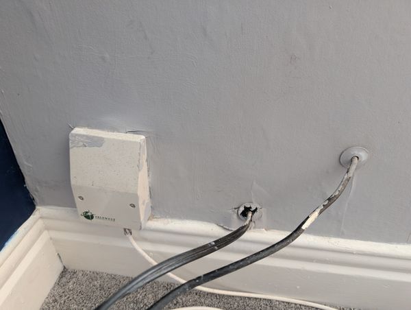

Just moved to a new place and supposedly its virgin compatible. The only box I can find in the place is an old Telewest box on the wall which looks ancient (below).
The box itself has two connections beneath, one saying "FM" and one saying "TV". The right side cable was able to connect with the red end of the cable provided by virgin, so I set it up using that, however the routers constantly flashing red now. The left black cable splits into 2 with wire stick out at the end. Have I set it up right or do I need to do something else?
Thanks in advance.

    Your VM connection shoud be the one marked TV on the Telewest box.
    Find the end of the white cable coming from TV on the Telewest box and screw that into the hub.
    Be careful not to cross the threads the connection only needs to be hand tight.
    Alternatively, unscrew the white cable from TV on the Telewest box and push fit the cable that came with your Quick Start kit onto the TV socket on the Telewest box. It may be a tight fit to push on.
    The dual black cable on the left looks like satellite TV (nothing to do with VM). Would need to see the connector on the end of the right black cable to try to identify what that does.
  • nodrogd's avatar
    nodrogd
    I would be suspicious of any Sky satellite installation coming in alongside a VM connection. Check on the other side of the wall to make sure the VM connection has not been cut or otherwise tampered with.
