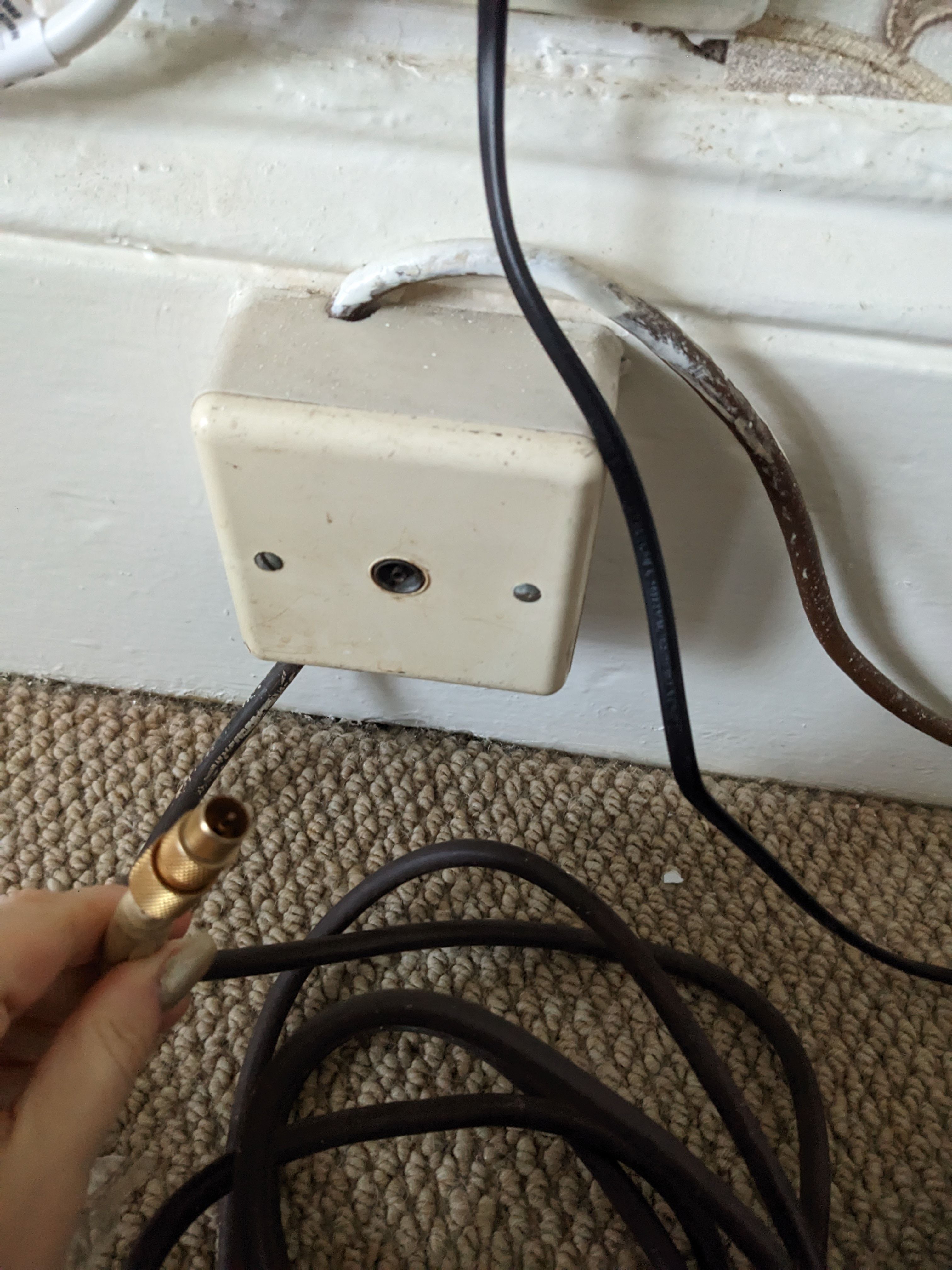

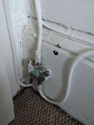

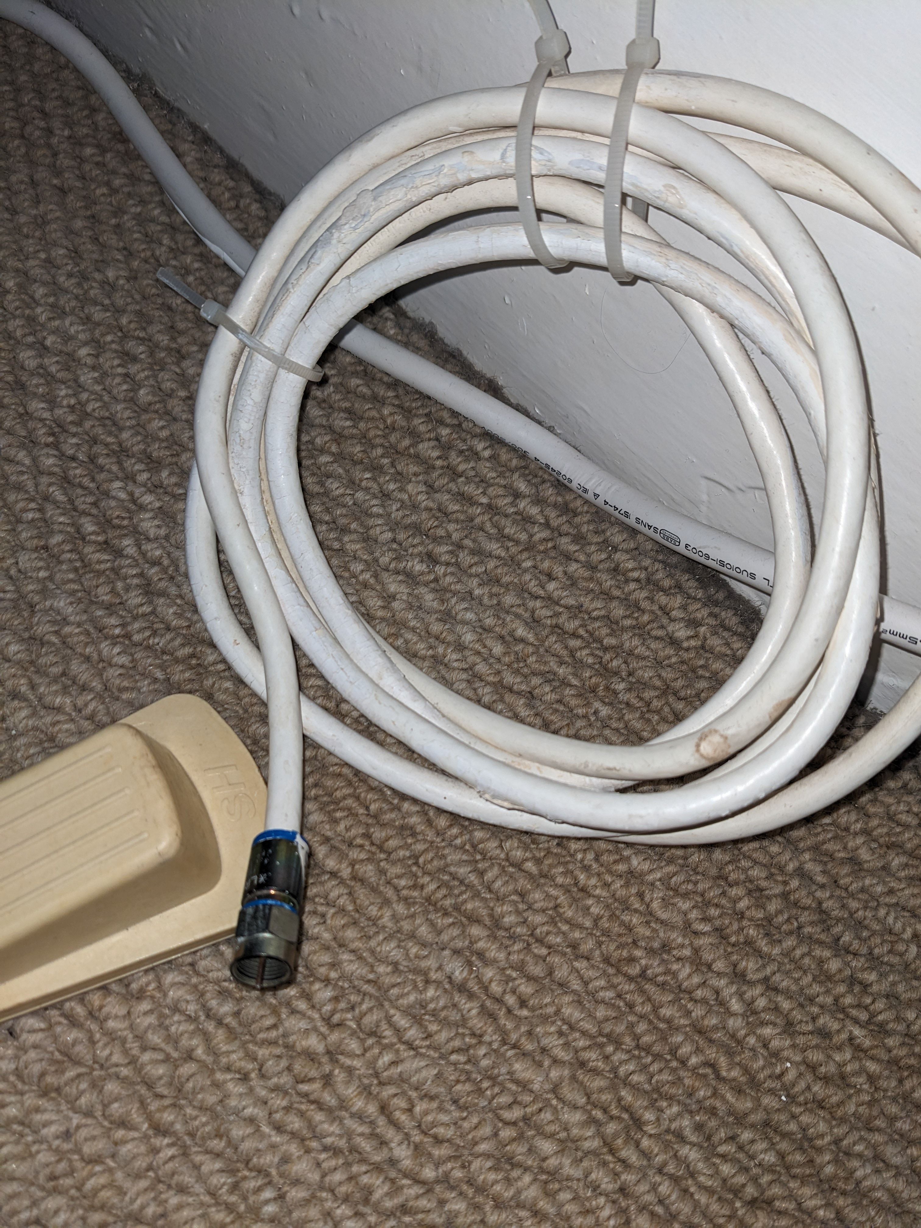

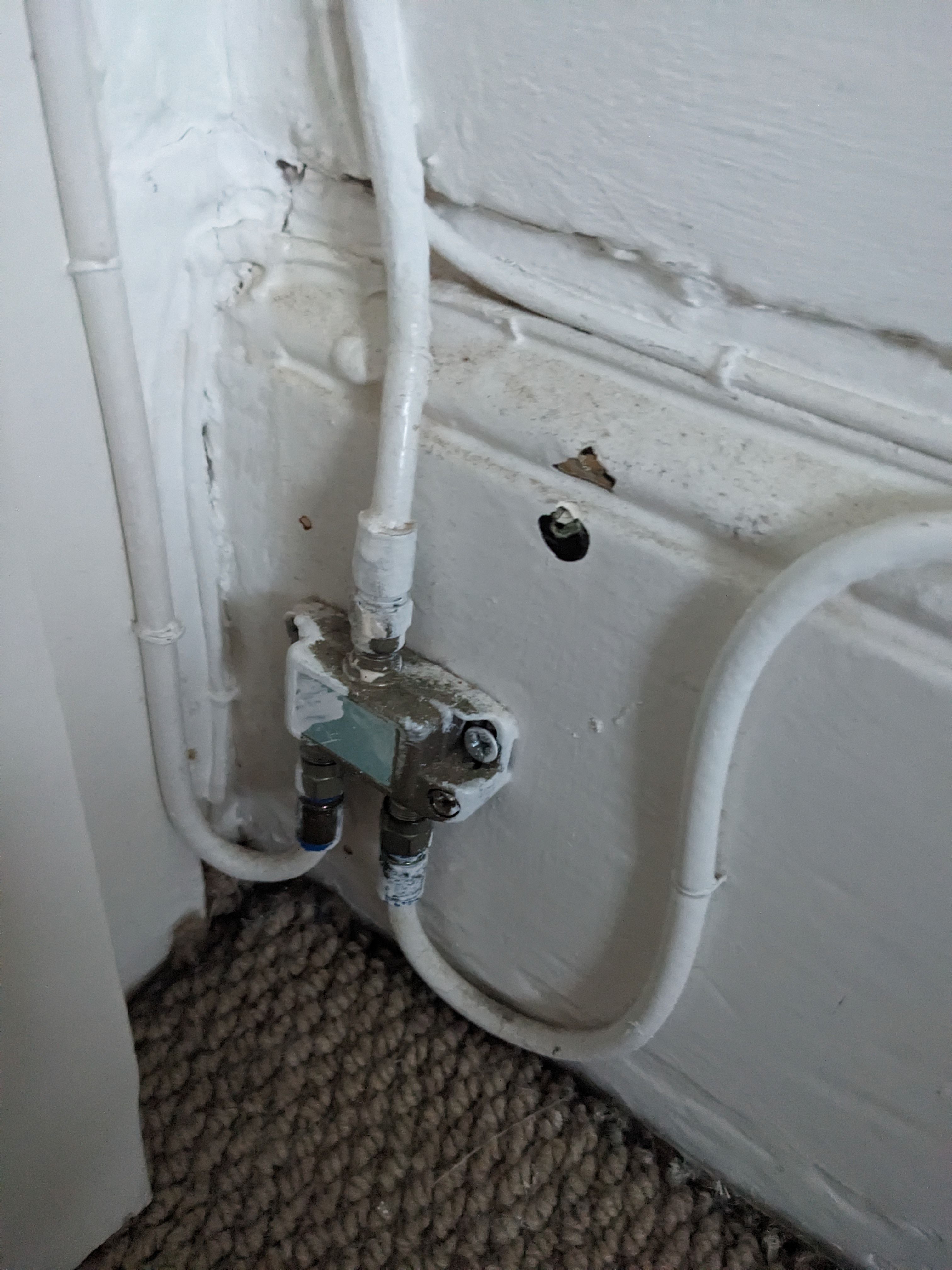

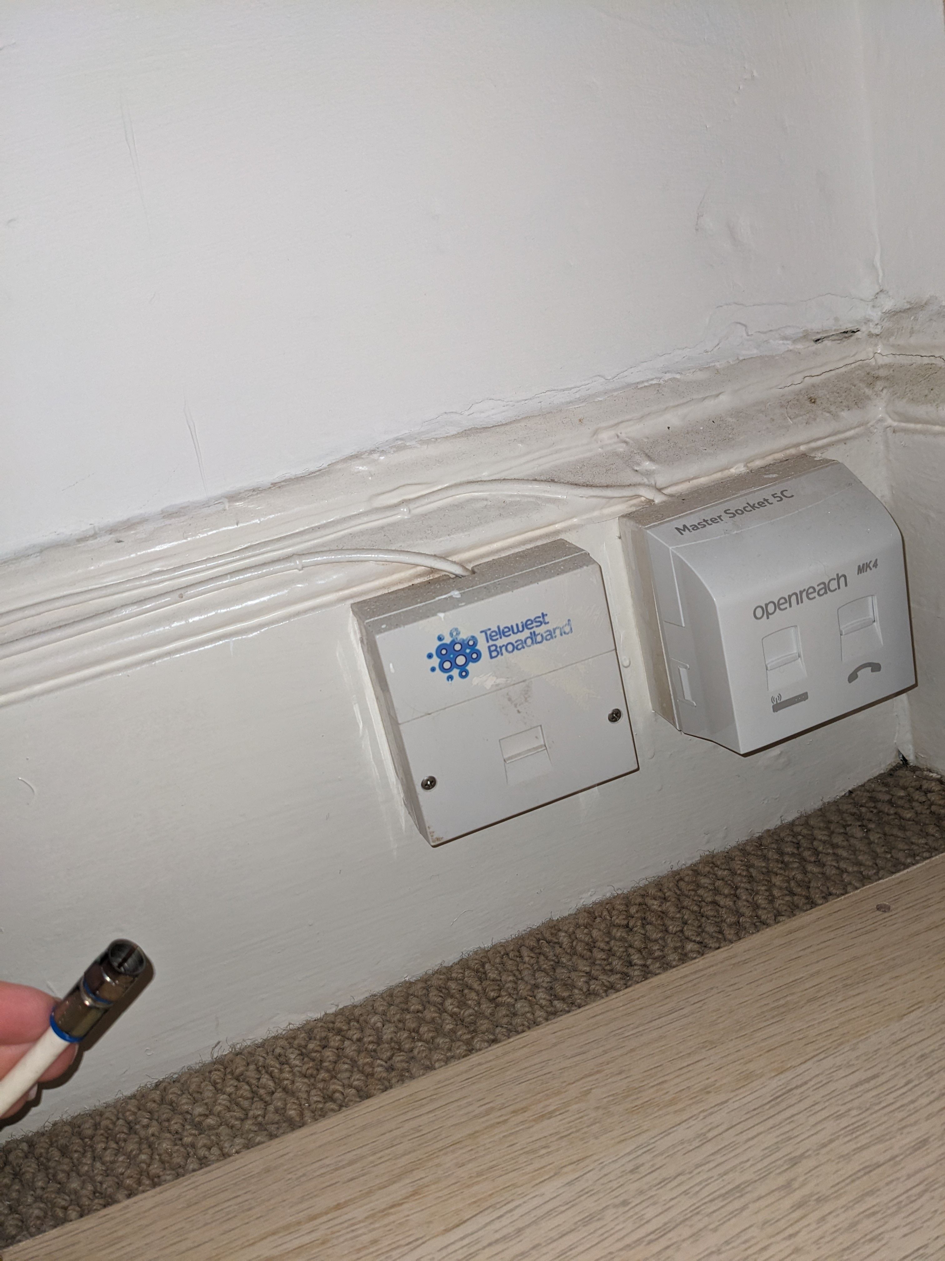

I've just received my setup parcel from virgin, however I've run into a few problems. This flat has an old telewest box and three different connector cables in different parts of the room. I'm a bit lost as to what needs to go where? I'm also not sure which box is the actual connection and which cable is the main one. None of the cables want to go into my hub? I'll post some pics below.

  • No they don't screw in all the way.  As for no internet, the cable may be disconnected in the street cabinet.  If you check the Status tab of the Hub's admin console, the "Provisioning State" will show if the Hub is offline or online.  It may be you will need a manned install to sort this out, and yes, they should cap the open ends of any cables or remove the redundant cables if they are not needed.
    Call the pre-installs team on 0800 052 1734 8AM- 9PM Monday - Friday or 8AM-6PM Saturday and Sunday, and explain your situation.  They should be able to assist with a manned install.

    The middle photo is the one: where do those two bottom cables go to?

      They go to opposite sides of the room and they don't plug into anything so it's just coiled up cable. Can't get them to plug into the hub either
      โ€ƒ
        Those are the โ€œolderโ€ screw in plugs.  That should just screw onto the Hub. Not all VM installs have a wall socket, mine is just a screw end like that picture.  However those ends really should have been capped with a 75 Ohm termination cap and not left open.  This can allow noise ingress back to the street cabinet and affect everyone on that circuit.
  • One of these three cables should run outside and be terminated to a cable that runs into VM's network:
