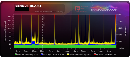

As you can see by the Latency Spikes and Dropped Packets, my router is completely disconnecting from the internet for short periods of time at random. This affecting all devises connected via wifi and cat6. Anyone also experiencing this know a solution? Restarted router and no change.78Views0likes1CommentMy Internet is disconnecting intermittently even with ethernet cable
