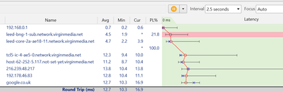

I've had recent issues with my broadband and it disappears for a min or so, or the wifi or Wired devices cant connect. Some times the router cant be found by the app!
So working in networking I started to look into the connection and found that the next hop from my router ( leed-bng-1-sub.network.virginmedia.net) is dropping lots of packets. The drops range between 20 and 50%. If this is common it will seriously impact the connectivity.

    I’m seeing exactly the same thing (using Ping Plotter also to see what’s happening). When the packet loss starts the Internet is nigh on unusable and it’s making it impossible to work from home.
    Had an engineer come in and they couldn’t figure out what was causing it. They said they’d put our connection on a watch list of some sort for a week to figure it out. It’s been much longer than that; no updates.
