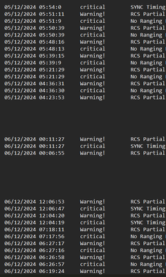

We have been dealing with more and more dropouts and disconections which can last between 30 seconds to minutes or until the Superhub gets restarted either manually or by itself, I have tried multiple things including reset/power cycle and have even had VM engineers out last year in Dec 2023, when they visited they replaced an old Coax splitter and said it was all fine (obviously is not) in Sept to improve WiFi we got a third party router which I didn't expect to fix problems just to improve the WiFi end since but the issues got worse??? we have since taken the other router out the equation and put the SH3 back into Routing mode and genuinely I don't know what to do, I ran a test with an Ethernet cable going from the SH3 in Modem mode to my PC and we get the speeds paid for it just goes out all of the time, I need help.
Before you ask yes I have setup a BQM but its not very conclusive but I will post if you ask.
Setup:
Virgin Media Superhub 3 VM M250 package
Logs: (these are from days ago but they still happen daily)

    The connection has logged tens of millions of Pre RS Errors & Post RS Errors

        Update: narrowed the issue down to Coax connection somewhere, drops connection when moved.
