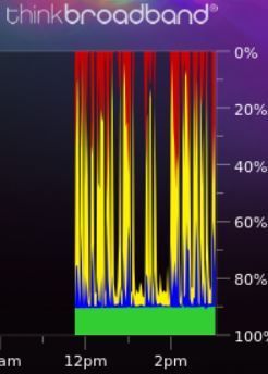

    There have been no listed faults in our area (website or phoneline you mention), and I've had a Think Broadband monitor running showing up to 50% dropped packets.
    2-3hrs patiently by me on the online chat and an engineer is arriving on monday (today is friday).
