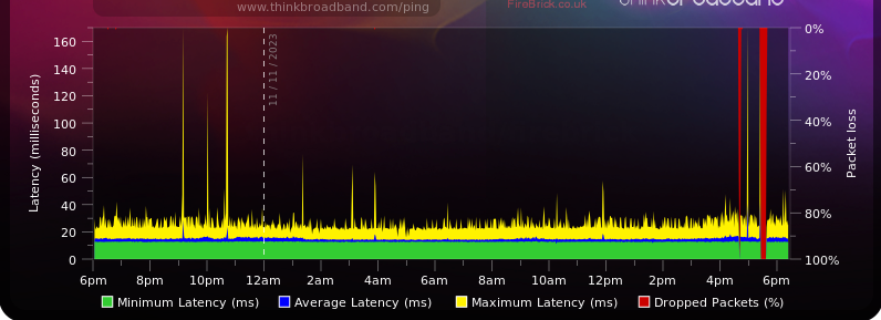

  • Adding to this (and cross posting) as seeing similar for past two days (10 and 11 Nov). Packet loss to Azure/msn.net for PUBG on PC. Measured packet loss was ~14%, varies in game and results in network lag reported in game.
    Tested on the Xbox after seeing this, that is reporting similar levels of packet loss on the connection test.
    Destination address at time of testing was 20.218.127.109
    |                       Host              -   %  | Sent | Recv | Best | Avrg | Wrst | Last |
    |                             192.168.0.1 -  100 |  228 |    1 |    3 |    3 |    3 |    3 |
    |                   No response from host -  100 |  228 |    0 |    0 |    0 |    0 |    0 |
    |swan-core-2b-ae19-650.network.virginmedia.net -    4 |  984 |  946 |    7 |   11 |   74 |    9 |
    | telw-ic-5-ae0-0.network.virginmedia.net -    5 |  972 |  931 |   11 |   16 |   87 |   13 |
    |    virginmedia.ier03.lon32.ntwk.msn.net -   14 |  737 |  636 |   12 |   17 |   75 |   24 |
    |         ae31-0.icr01.lon22.ntwk.msn.net -   14 |  749 |  651 |   13 |   19 |   97 |   16 |
    |       be-100-0.ibr01.lon22.ntwk.msn.net -   14 |  749 |  651 |   24 |   31 |  190 |   31 |
    |        be-15-0.ibr01.ams30.ntwk.msn.net -   13 |  753 |  656 |   24 |   30 |  168 |   31 |
    |        be-14-0.ibr01.fra21.ntwk.msn.net -   12 |  777 |  686 |   24 |   29 |   87 |   27 |
    |        ae100-0.icr01.fra21.ntwk.msn.net -   14 |  749 |  651 |   23 |   30 |  100 |   43 |
    The connection seems to degrade between telw-ic-5-ae0-0.network.virginmedia.net (62.253.174.186) and virginmedia.ier03.lon32.ntwk.msn.net (104.44.14.51).
    Tested briefly by tethering my PC to my mobile phone and the connection was much improved, albeit taking a different route.
    My broadband connection seems to have been stable, the dropped packets in this case are reboots of the hub.

  • jbrennand's avatar
    jbrennand
    Lets see the data - can you do this..
    In your browser’s URL box type in http://192.168.0.1 (or http://192.168.100.1 - if in modem mode) (DONT click these links) - and hit return. No need to log in - just click on the “Router Status” icon/text at bottom-middle (Hub3/4/5) or top/right (SH’s) - of the Login page.
    Then… Navigate to these “data pages” and just copy/paste the normal “Formatted Text” (not images) 3 FULL sets of data onto here – 2 tables from the Downstream, 2 from the Upstream, & the Network Logs pages. Don't worry too much about the formatting it can be easily read & DON’T include personal data or MAC addresses - blank them out - if you copy/paste the data, the board software will do this for you (you may need to click the "submit" button again). If character limits are “exceeded” - just do two posts
    Also, If you haven’t already, set up a free, secure and “offlsite” - “Broadband Quality Monitor” to continually monitor the state of your connection and record any true network dropouts , latency issues, packet drops, etc - it will thus allow you to differentiate between those and simple wifi dropouts. It does it 24/7/365 and it keeps a visual record of any/all of your network disconnections, useful data to have to match to the Network logs (in your Hub settings) and also in discussions with VM - note it will take a few hours to start seeing a sensible picture - post up the “link” to the “share live graph”. Click the lower link (Share Live Graph) then, click generate. Copy the text in the Direct Link box, beware, there may be more text than you can see. On here click the Link icon (2 links chain to the left of the camera icon) In the URL box paste the link you copied and then click OK

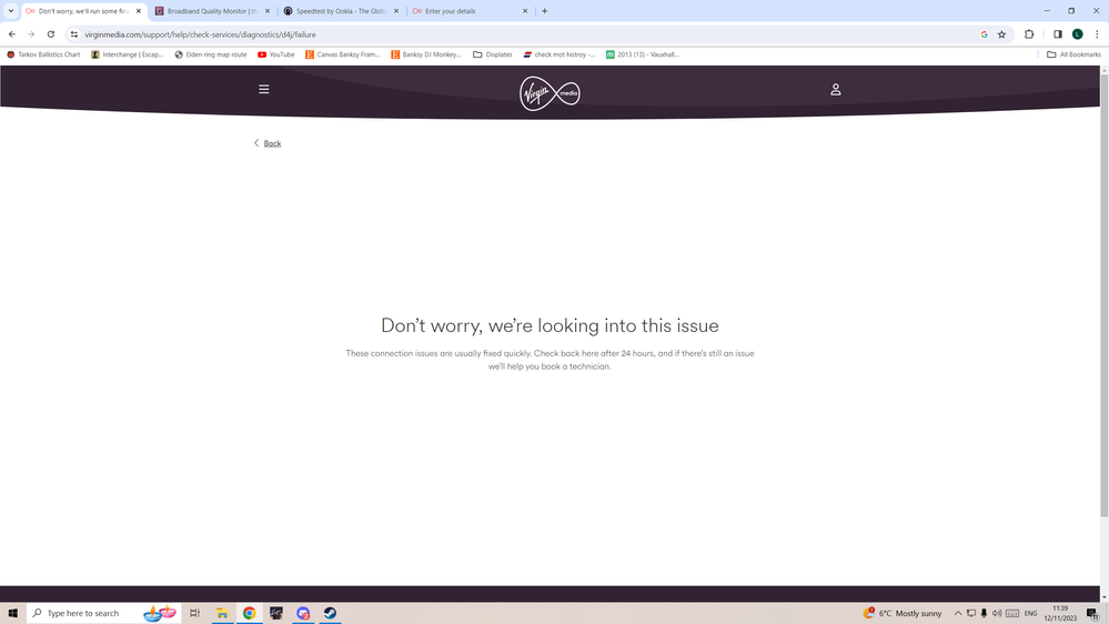

    • fairless94's avatar
      fairless94
      I'm still getting issues, its really annoying. Virgin saying there is an intermittent problem but its been like this since yesterday.
