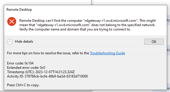

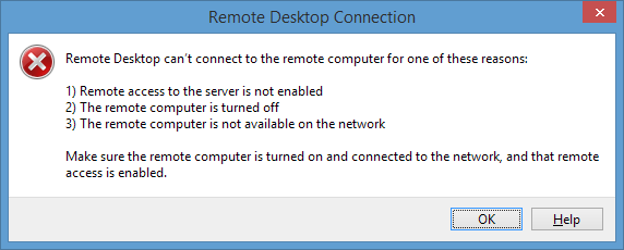

I get a response from : nslookup rdgateway-r1.wvd.microsoft.com
But I get "not reachable" from : ping rdgateway-r1.wvd.microsoft.com

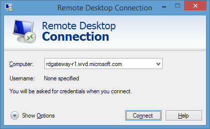

Are you wishing to rdp direct from your VM connection to rdgateway-r1.wvd.microsoft.com ?
or do you first connect a office VPN & then rdp ?- MannystkJust joined
its direct from my VM to the RDP
- legacy1Alessandro Volta
Remove router connect laptop to hub in modem mode power off for 2 mins
also change DNS to 1.1.1.1 , 8.8.8.8 or 9.9.9.9
- Client62Alessandro Volta
A using a Public DNS does not make rdgateway-r1.wvd.microsoft.com reachable.
I forced the dns change in my router before and it didnt fix the issue
Ping rdgateway-r1.wvd.microsoft.com from the link below ... it sure looks to be offline to me.
https://www.host-tracker.com/en/ic/ping-test- MannystkJust joined
There are hundreds of other staff who manage to connect to the same address - So it is online
I am out of ideas.
