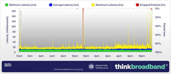

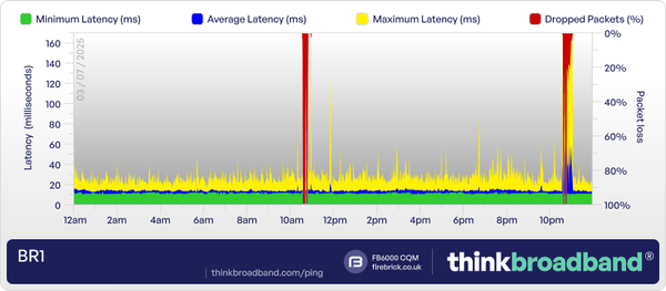

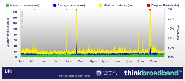

    I've been monitoring this since the engineer visit, and it seems there's two noticeable spikes between around 9am-noon and then again at 9-midnight. At this time I see my modem upstream power rise from 52 dBmV to 59 dBmV, and the QAM often drops to 32 or 16.
    This is also visible on the BQM before the engineer visit, though then it would always cause the connection to drop out entirely.
    It seems the service tracker saying "Intermittent signal in area" may not be a lie after all. Can anyone from Virgin comment on whether the networks team are aware of this?
    I can see it happening right now, as it's almost 10pm.

        I had a second engineer visit on Friday and he moved me to a different tap (and tap bank), which has brought all the values back into spec, given me 5 + 1 upstream channels, and also seems to have resolved the noise issue (though I did have a bunch of noise Friday night between 11pm-1am, but that may have just been maintenance; not seen it since).
        I do suspect there's still an issue with that cab given how regular the noise pattern was (basically every 12h like clockwork), but as it's no longer affecting my connection I can't get any more data on it.
    You mentioned an attenuator on the line to the Hub 5.  Is it still there ?
    If that is a Wideband attenuator, removing it would have the effect of causing the Downstream Power levels to increase, and the Upstream Power levels to decrease.
    Might be worth a try, you can re-instate the attenuator if there is no improvement.
