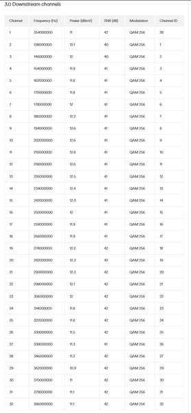

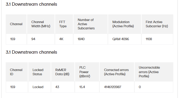

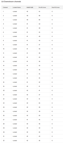

High power levels affecting connection.
Hi,
I have recently moved house and below are my current power levels already with a 6db Wideband Attenuator attched, which was left by the previous owner of the house.
I am having some connection issues now and then along with quite a few daily "DBC-REQ Mismatch " warnings in the hub network log so it seem the 6db might not be enough.
Please can i request an engineer so this can be looked into :)
Kind regards
  • Thank you for arranging an engineer to come out.
    He confirmed the levels were high. Hes replaced the box / internals on the wall where the line comes in as it was old and added a newer 10bd attenuator onto the back of the router.
    Noise isnt "Perfect" but much better sitting at around 6 - 8db on the downstream for 3.0.... 7db for the 3.1.
    He advised that is didnt want to push the noise lower as other levels can start to be affected but currently all his tests passed and any further issues to contact again.

      Hi,
      These are the levels with the 6db attenuator removed
      • unisoft's avatar
        unisoft
        Super solver
        You have DocSIS 3.1 channels. You need engineer to fit an Equalizer not the old attenuator (these usually had a pinkish rectangle label stating level of attenuation e.g. 6db).
        The equaliser is needed for DocSIS 3.1 channels as it will attenuate the stronger signals, but not affect the weaker ones used for DocSIS 3.1 channels. It is selective on frequencies whereas the standard attenuator does everything. The engineer will know if your area runs DocSIS 3.1 channels on the weaker spectrum, most areas do. You can't merely go by power levels alone. You'll probably need the equivalent of a 10db equalizer.

      My post with snips needs to be approved but the levels increase to around 15 - 17ish with the 6db attenuator removed
