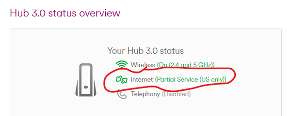

    I have re-opened this chat again. My internet dropped again this afternoon due to T3 timeouts and now it is back on. It's been up for almost 2 hours and "appears" stable and speeds seem OK too. However, my router is reporting errors and think an underlying issue is beginning to surface.
    Firstly, there is this:
    Here are my downstream figures (there are pre-RS errors):
